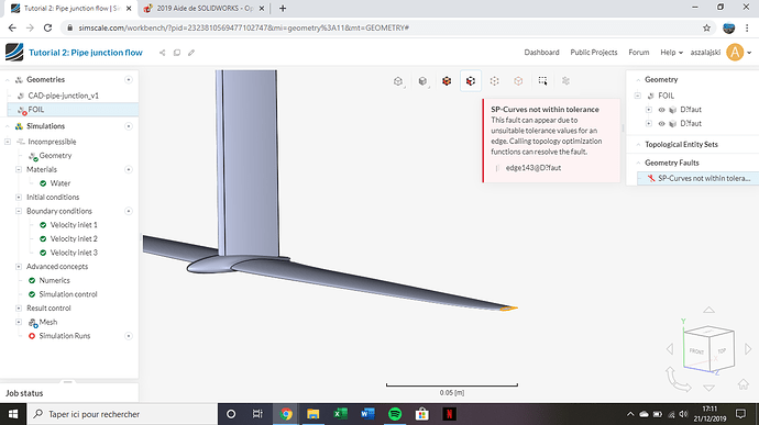

I’m a french student working on a foil for a school project. I made a CAO maquette on Solidworks, and I can’t begin simulations in simscale because of a topology issue, that i can’t solve .
here a picture of my project:
Thank you

Hey @aszalajski,

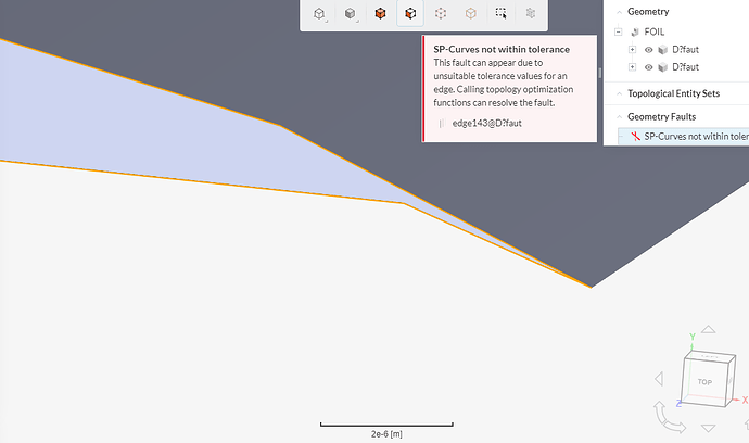

I believe this very sharp edge is the cause of the problem:

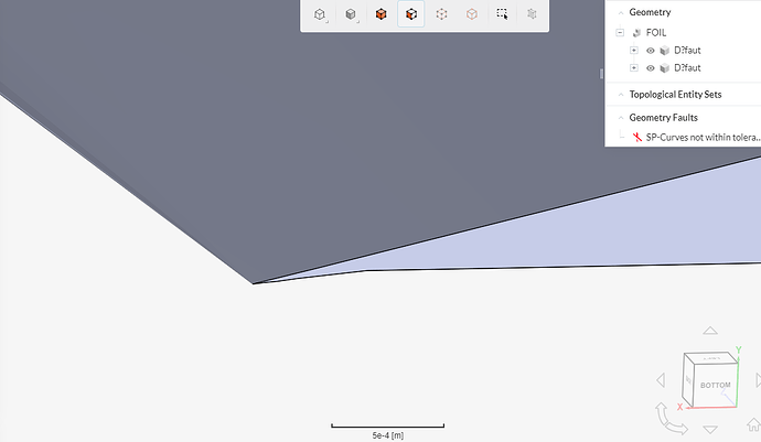

For some reason, only this side of your model had issues. If you check this face on the other side of your model, it looks “less edgy”:
Try to fix it in your local CAD software and let us know if it worked.
