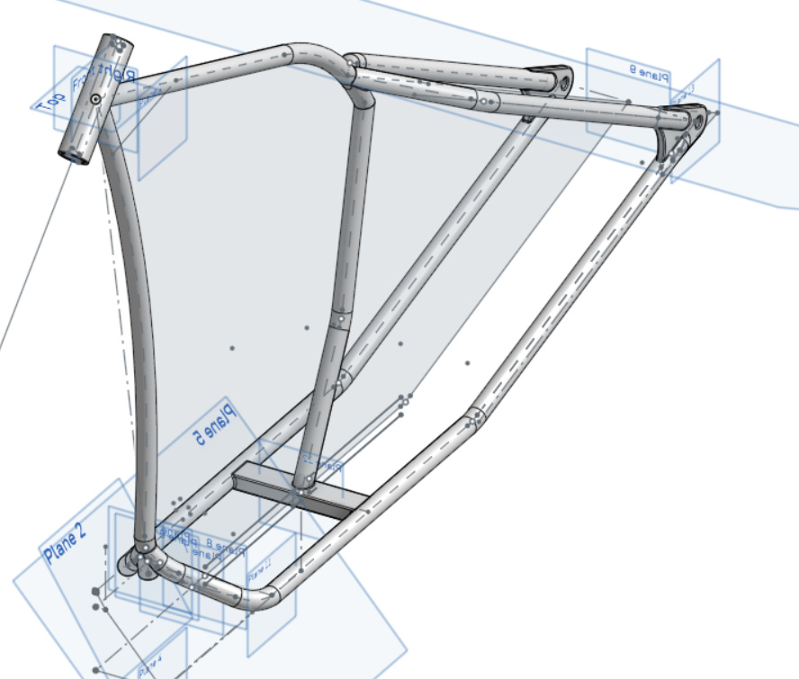

I am working on FEA of a motorcycle chassis
I was trying to mesh it in Simscale for a FEA linear static analysis, and I was not able to successfully create a mesh with Tet-dominant mesh, but I was able to create a mesh with the standard mesh.

Hey there and cool project by the way!
The standard mesher is the way to go and the one I would actually use because (and as you already noticed) the success rate of this mesher is higher and can handle problems with the geometry better - more information can be found here: Standard Mesher | Meshing for CAE | Documentation | SimScale
