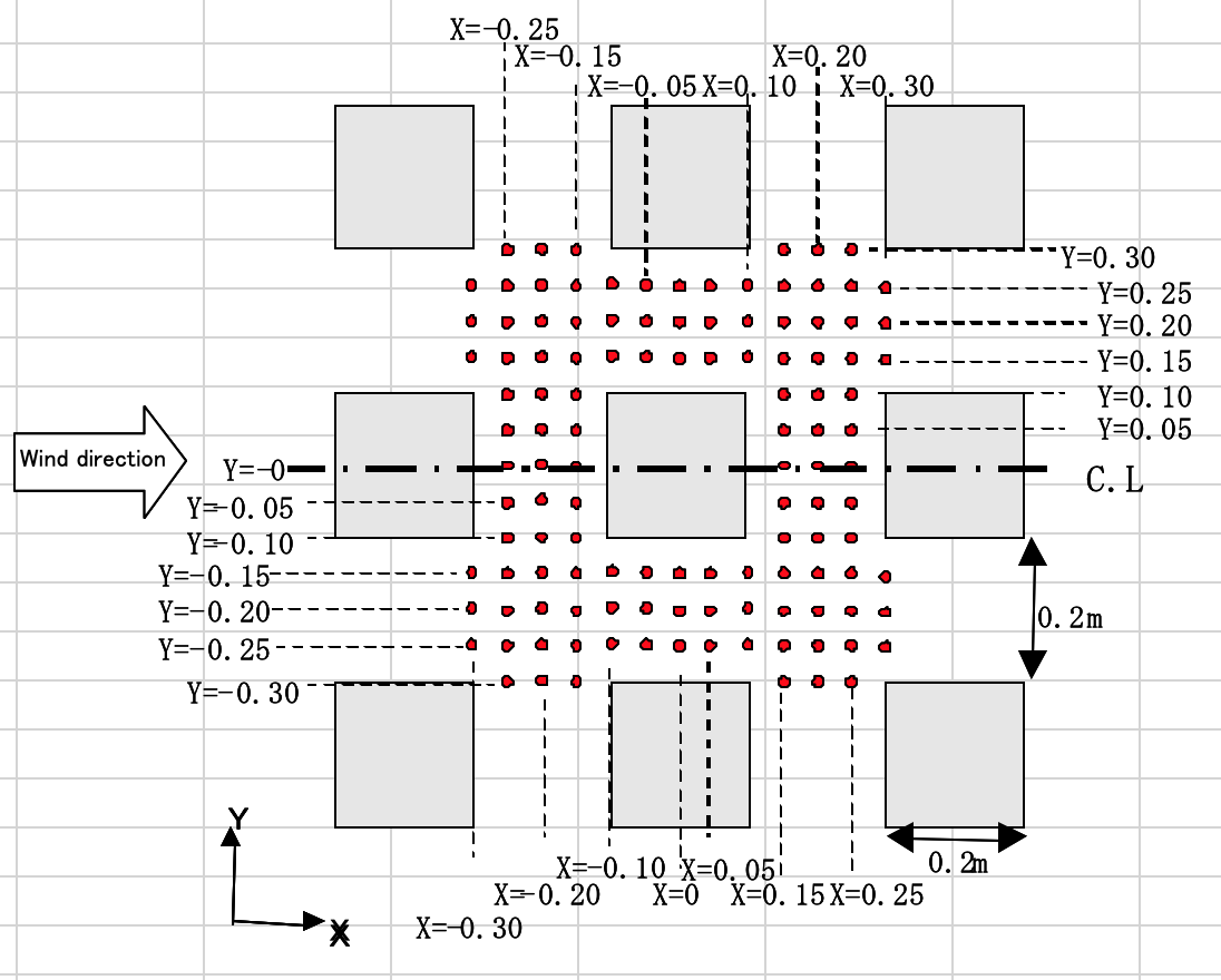

I am trying to complete a CFD validation of wind flow over 9 square buildings for which experimental data are available. Velocity data have been obtained at 120 different points using probes in a wind tunnel. The coordinates of these points can be seen in the attached picture. I am therefore trying to find a quick way to extract these measurements, without setting 120 probe points. Any suggestion is kindly appreciated.

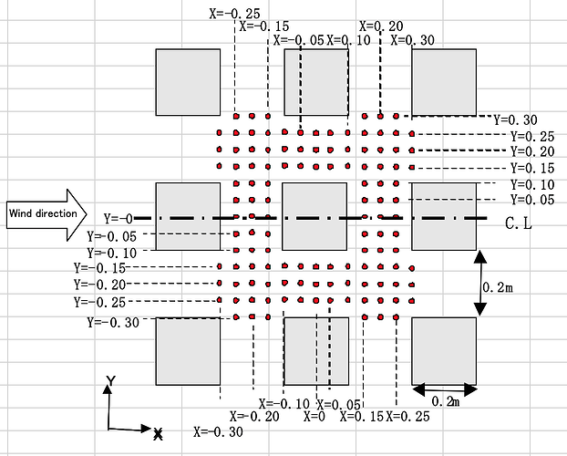

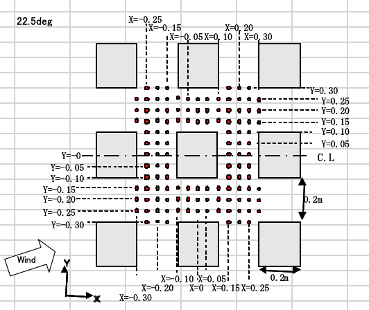

My goal is also to rotate wind’s direction and complete a second validation study. For this second case, the probe points and buildings remain fixed. Therefore, I would like to know if there is a way to simply rotate wind direction (i.e. the orientation of the Background mesh box) while keeping the geometry and probe points coordinates fixed. A picture illustrating this second validation case is also attached.

First validation:
Second validation:
