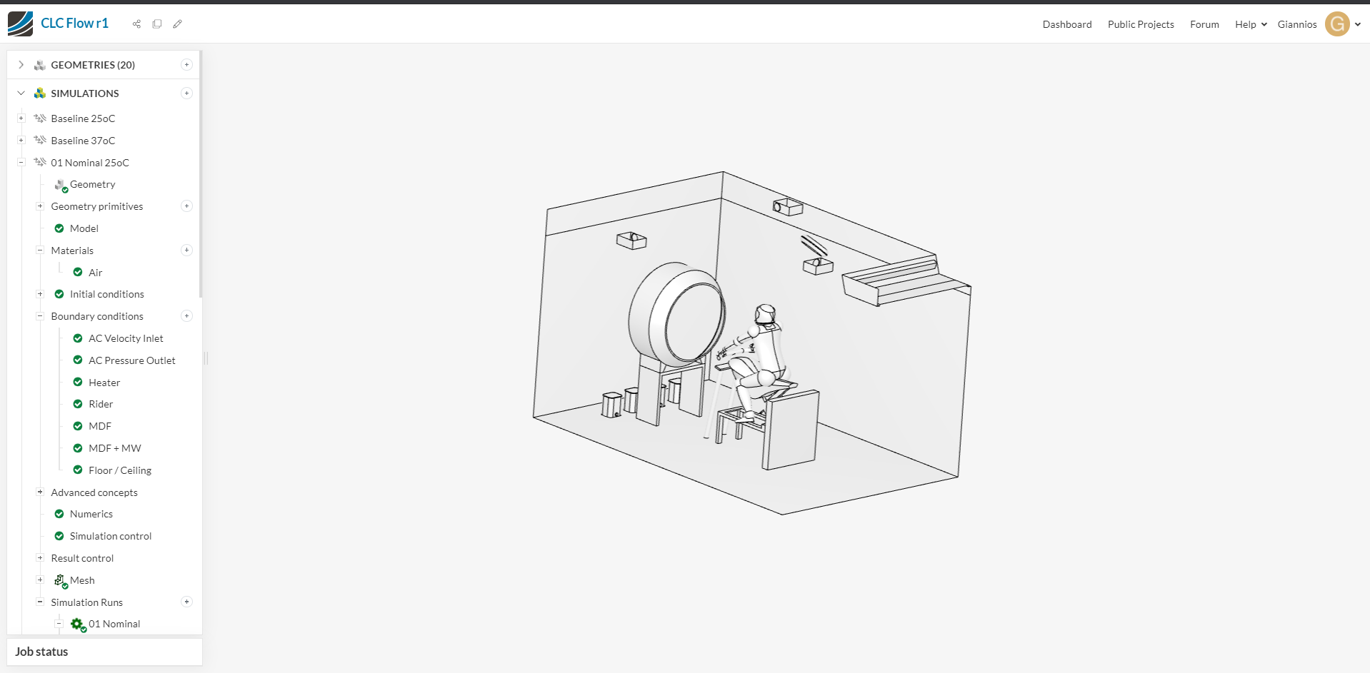

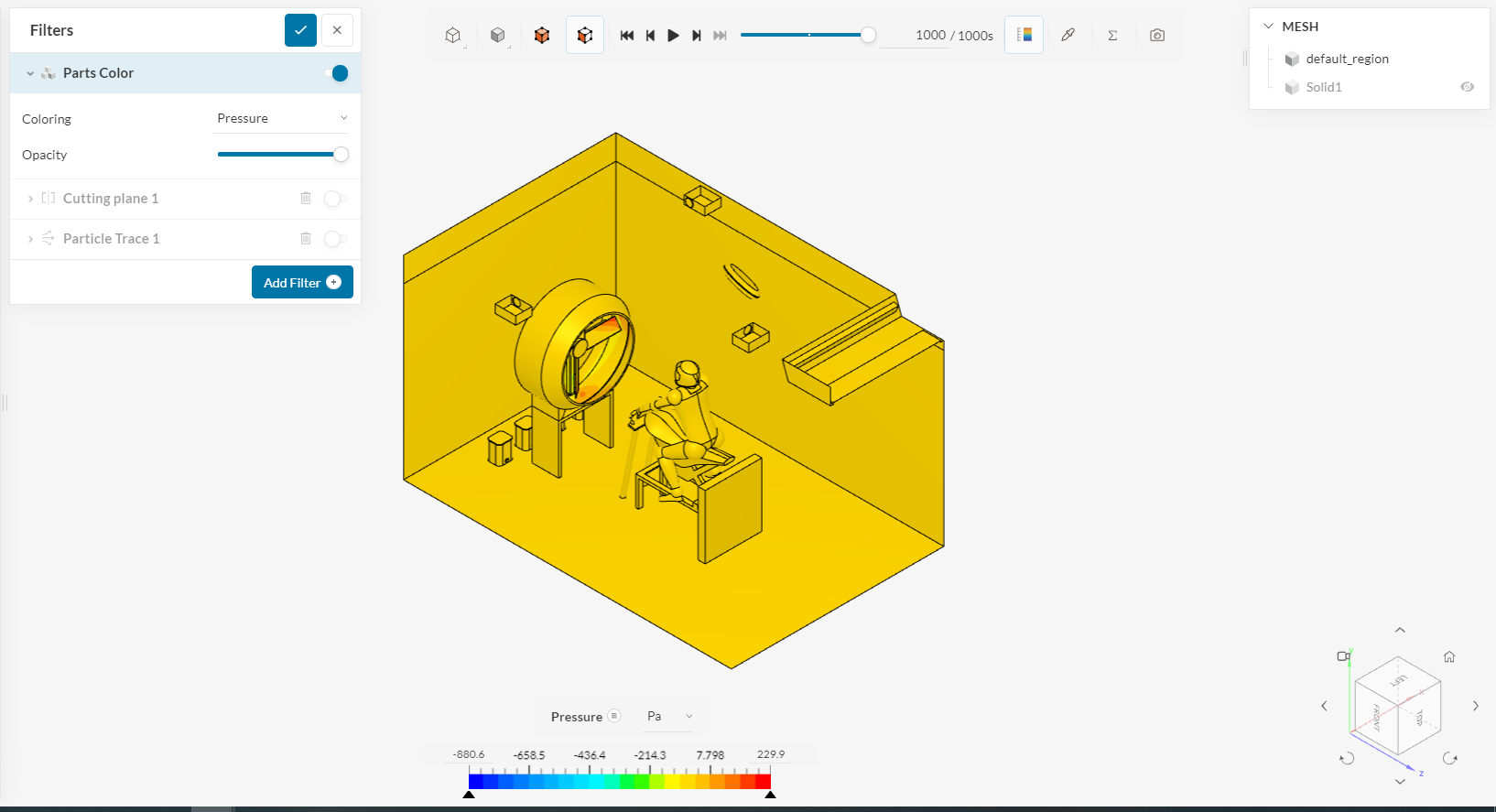

The following screenshots come from the “01 Nominal” simulation.
As you can see, when I choose anything apart from “solid color”, the toolbars are on the screen.
However when I choose solid color, everything disappears.

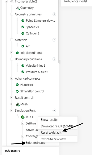

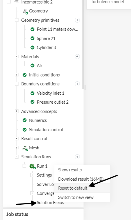

As a side note, resetting the post-processor to default solves almost all post-processing issues that you may have.
You can do that with a right-click on “solution fields” and then the reset option will appear.
