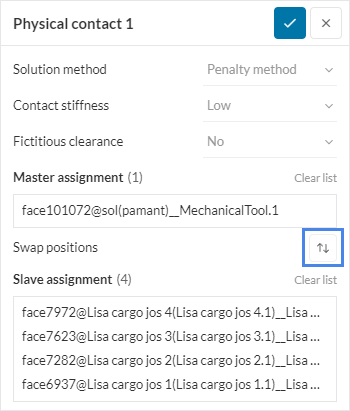

This error can be solved by switching the assigments of the physical contact. Use the highlighted button to achieve this:
Hi, thank you for your replies at my questions! While the first one was just something I was unsure of, the second issue was a real nightmare for me. Fortunately, it finally worked out, after switching the master and slave assignments for the physical contact(as you instructed me) and deleting some of the contacts defined in the geometry. Thank you again for your support!
