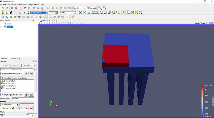

I tried to download the results from the latest run (Run 9) and open the case.pvd file in ParaView. It seems to work fine to me:
I’m using ParaView 5.7 (I believe the latest beta version is 5.9). Perhaps it’s worth giving it a shot with one of the older and more stable versions?
