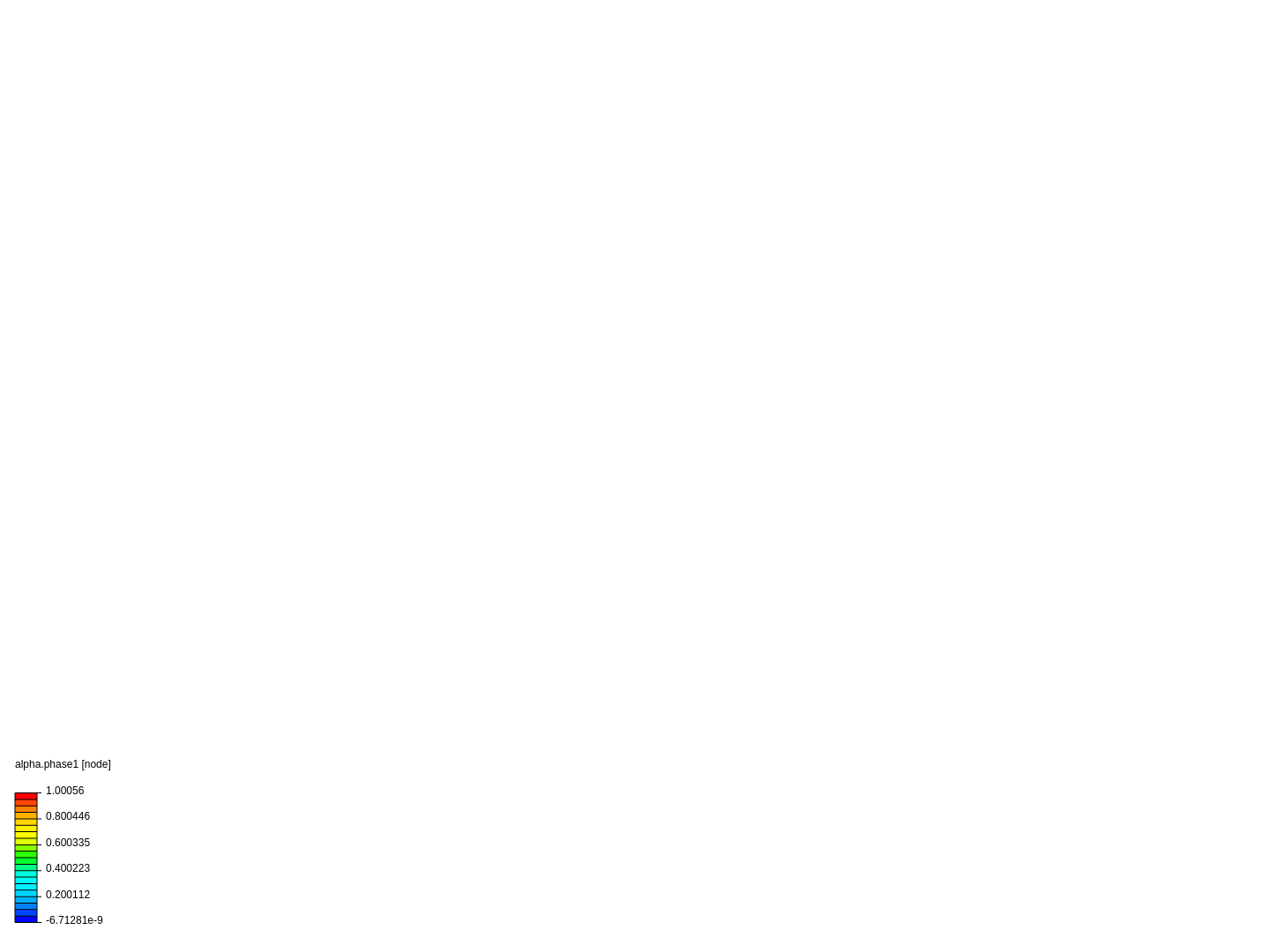

To start with one of my own, this doesn’t seem to get very much further than initialising the domain:
I can see from post processing what limited results I have that the domain has initialised correctly, but not gone any further.
It’s a multiphase simulation of flow past a planing boat hull, which I’ve simplified to the bones to try to get it running, but no luck!
