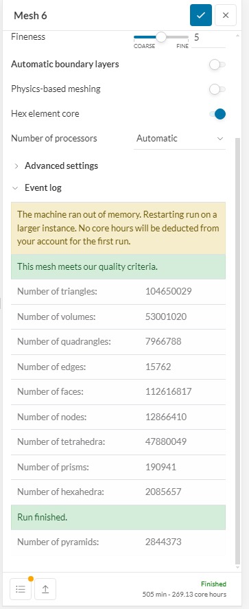

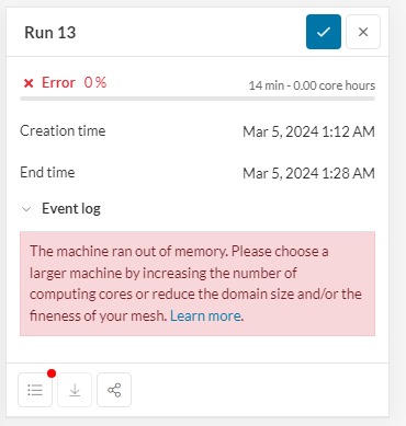

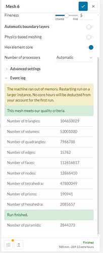

I have a error in my simulation. here is the screenshots of the error and meshing event ( ıf you have a advice about it) and I invited to you to see my project
