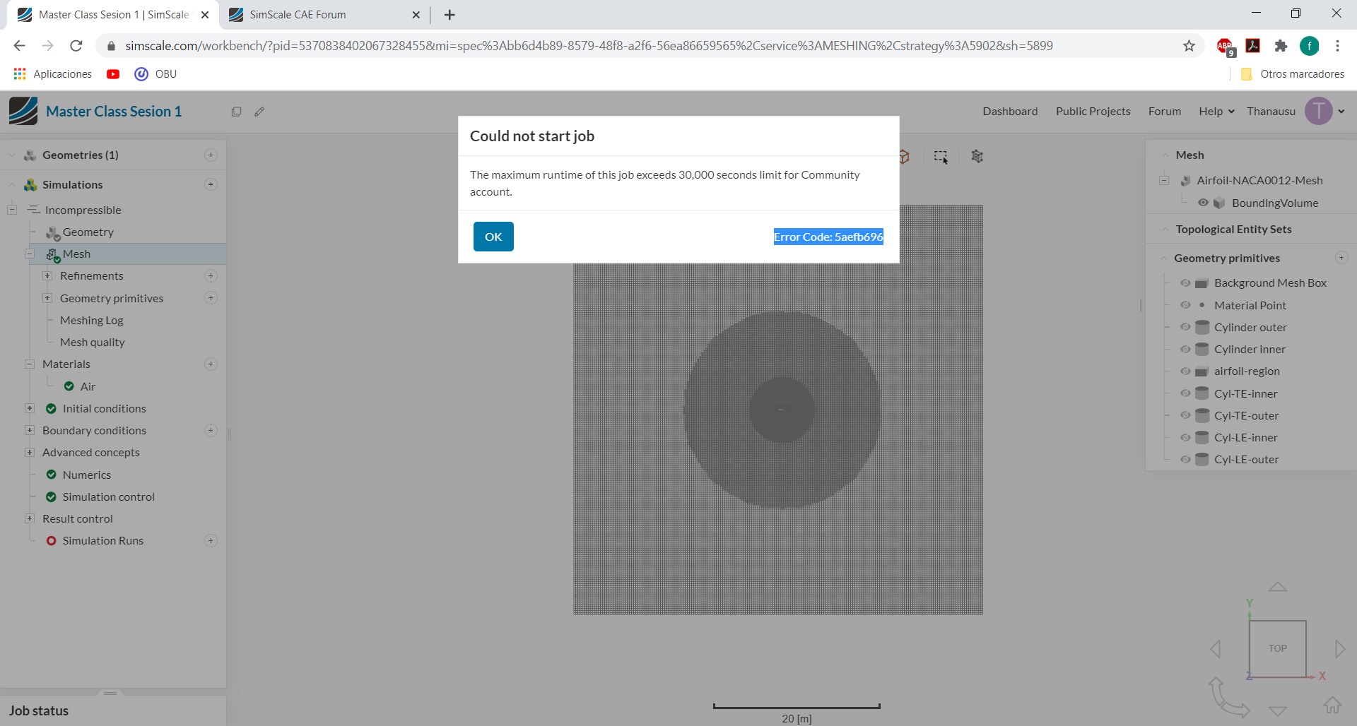

Could Someone answer me how to solve this issue?, The program gave me this error when i was trying to simulate a cfd analysis. Photo attached below.

Hey @Thanausu,

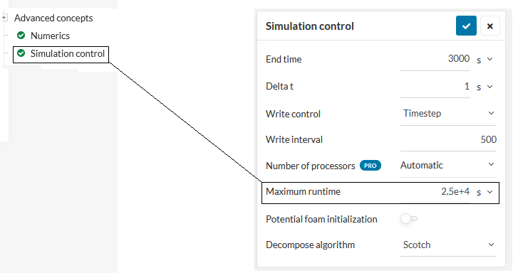

You defined the maximum run time as 120,000s. For the community plan, the limit for this parameter is 30,000s. You can change the value for 25,000s. It should do the trick.
