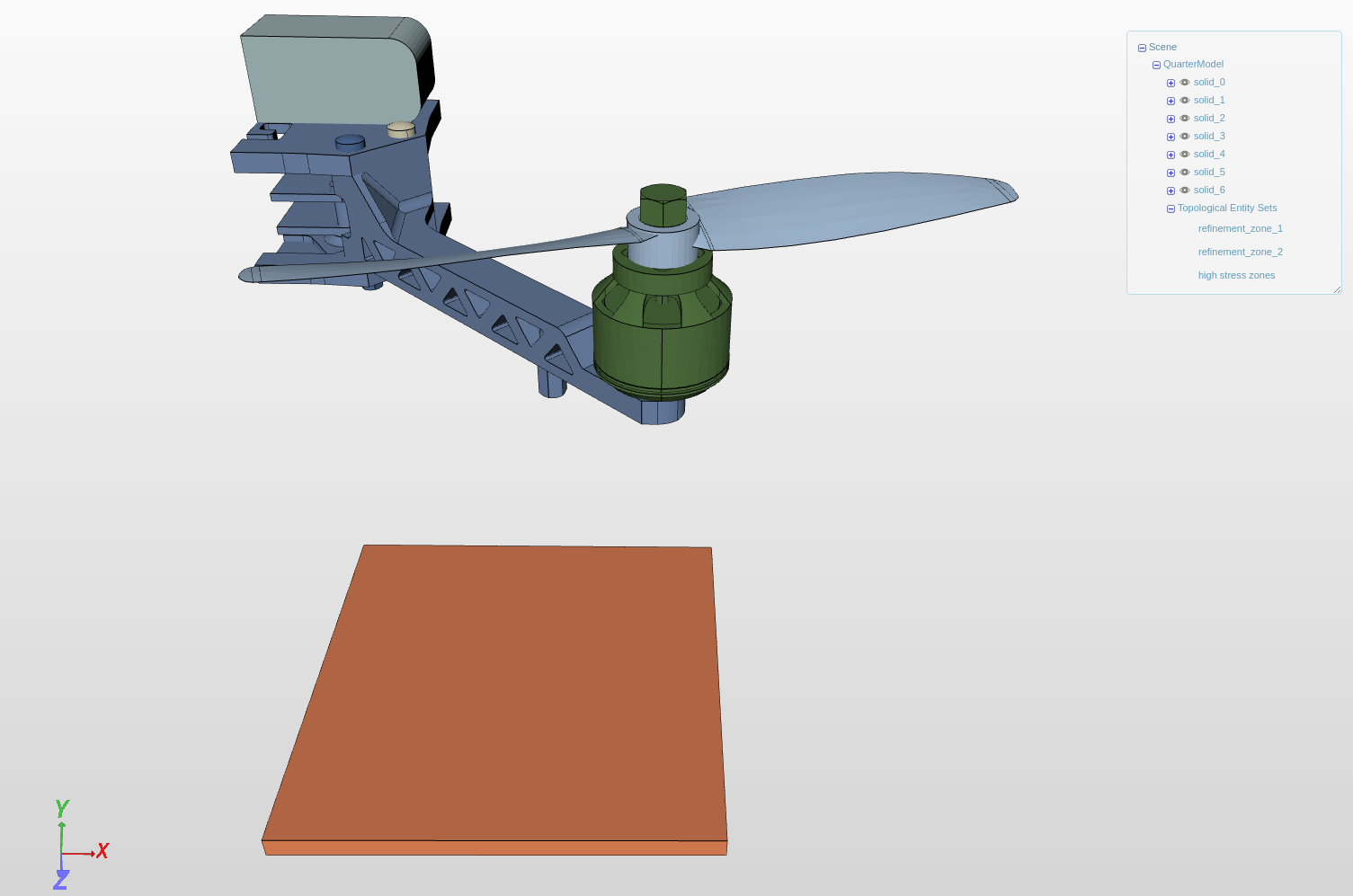

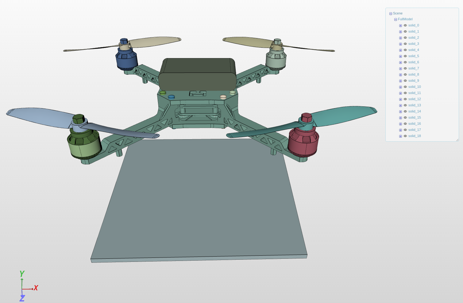

Geometry
The entire geometry of the quadcopter with the steel plate is shown in the figure below.

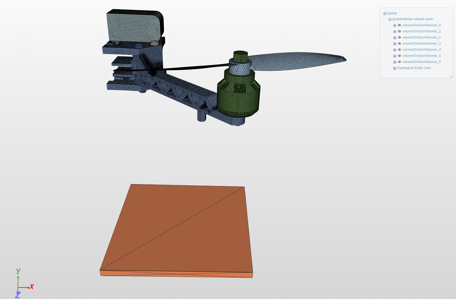

Due to the symmetry of the model, only a quarter of it was taken into consideration for the analysis. Doing this helped in reduce the mesh size and the computation time. The quarter model is shown in the figure below.
A Tetrahedralized mesh with refinements is utilized. Two types of meshes are made; moderate and refined. Some of the curvatures are refined in order to capture stresses more accurately. The refined mesh is shown in the figure below.

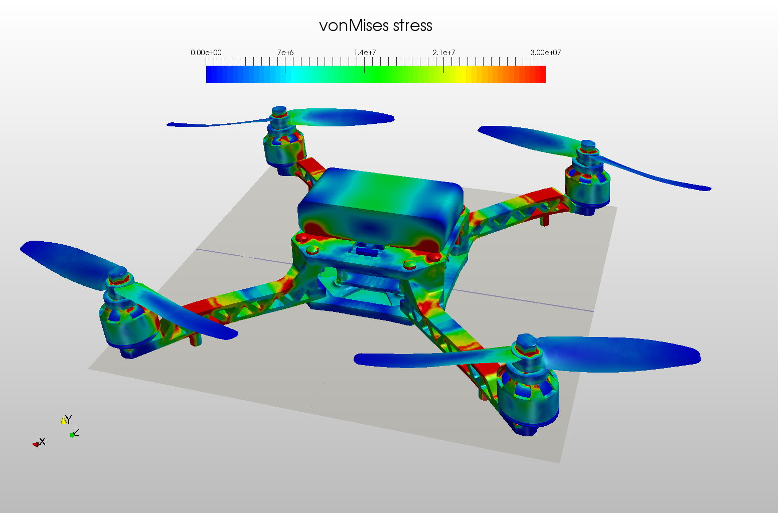

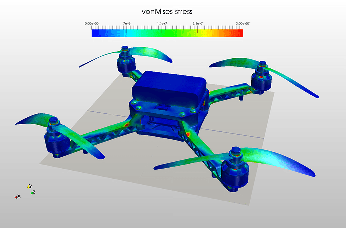

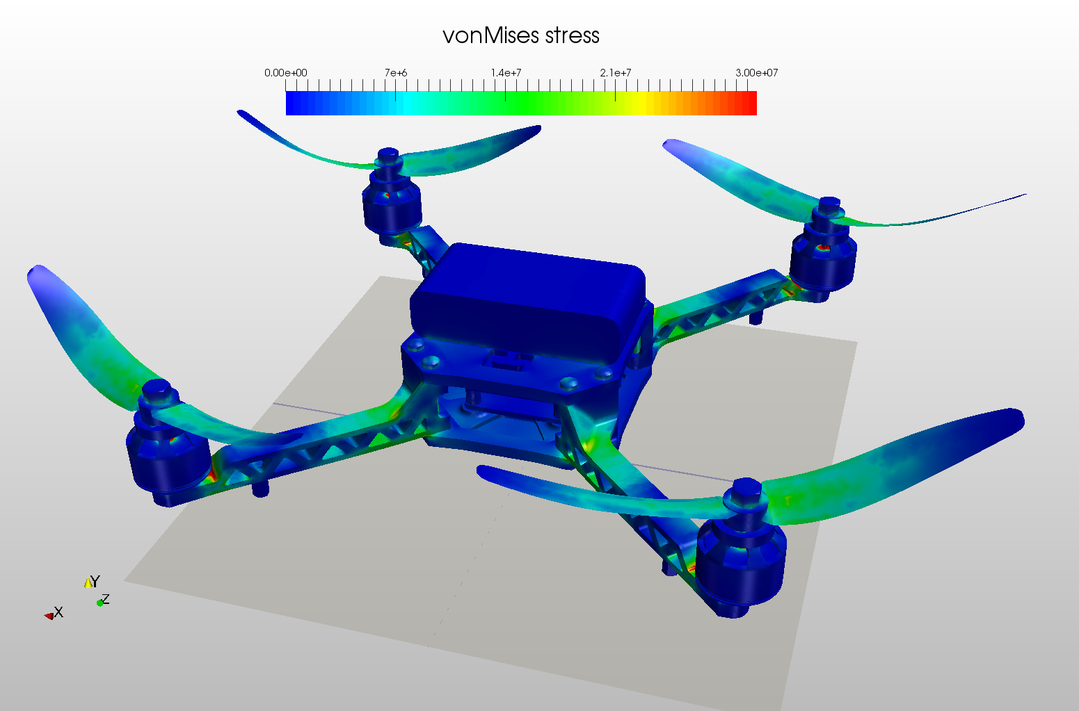

The figures below show the vonMises stress across the entire drone at 3 different intervals.
  1. Maximum impact
  2. Just after the impact
  3. Final stage

    Note: For post-processing purpose, the geometry was reflected along each plane to get a full model.
How can I get the results of drone at the moment touching the floor? Or the last GIF image? The reflection along a frame?
@hgurav for this you have to use locally Paraview… Use reflect filter to reflect along certain axis… Use WarpbyVector filter to see the movement of the drone… You can than save the animation
