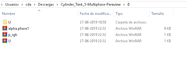

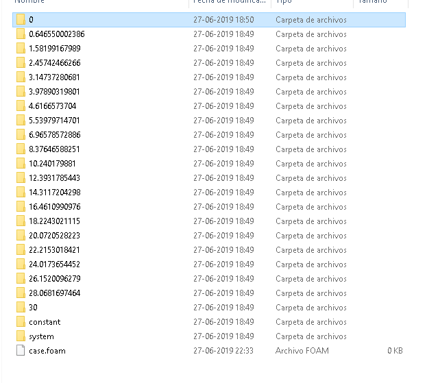

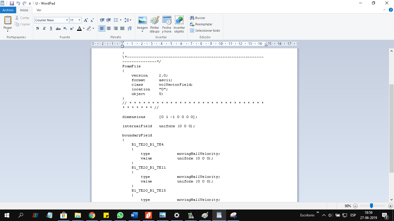

I downloaded the results and the folder and files are ok.

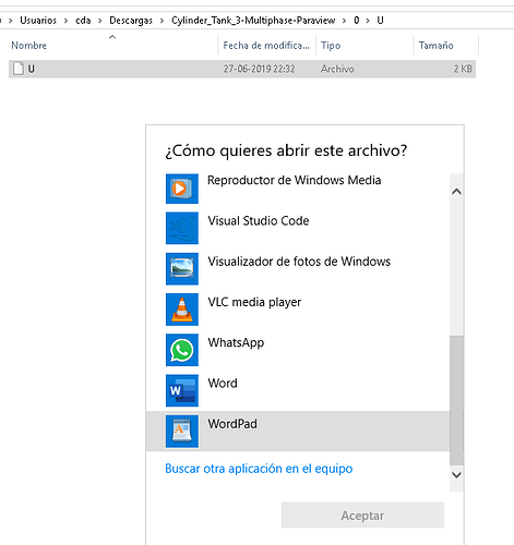

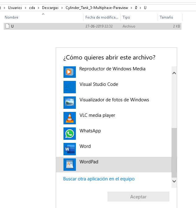

I unzipped the U folder in 0
and i opened whit wordpad
the files of the boudayrs are okey

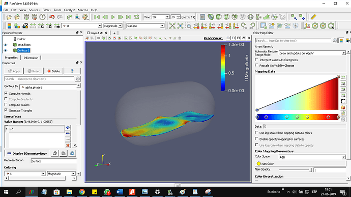

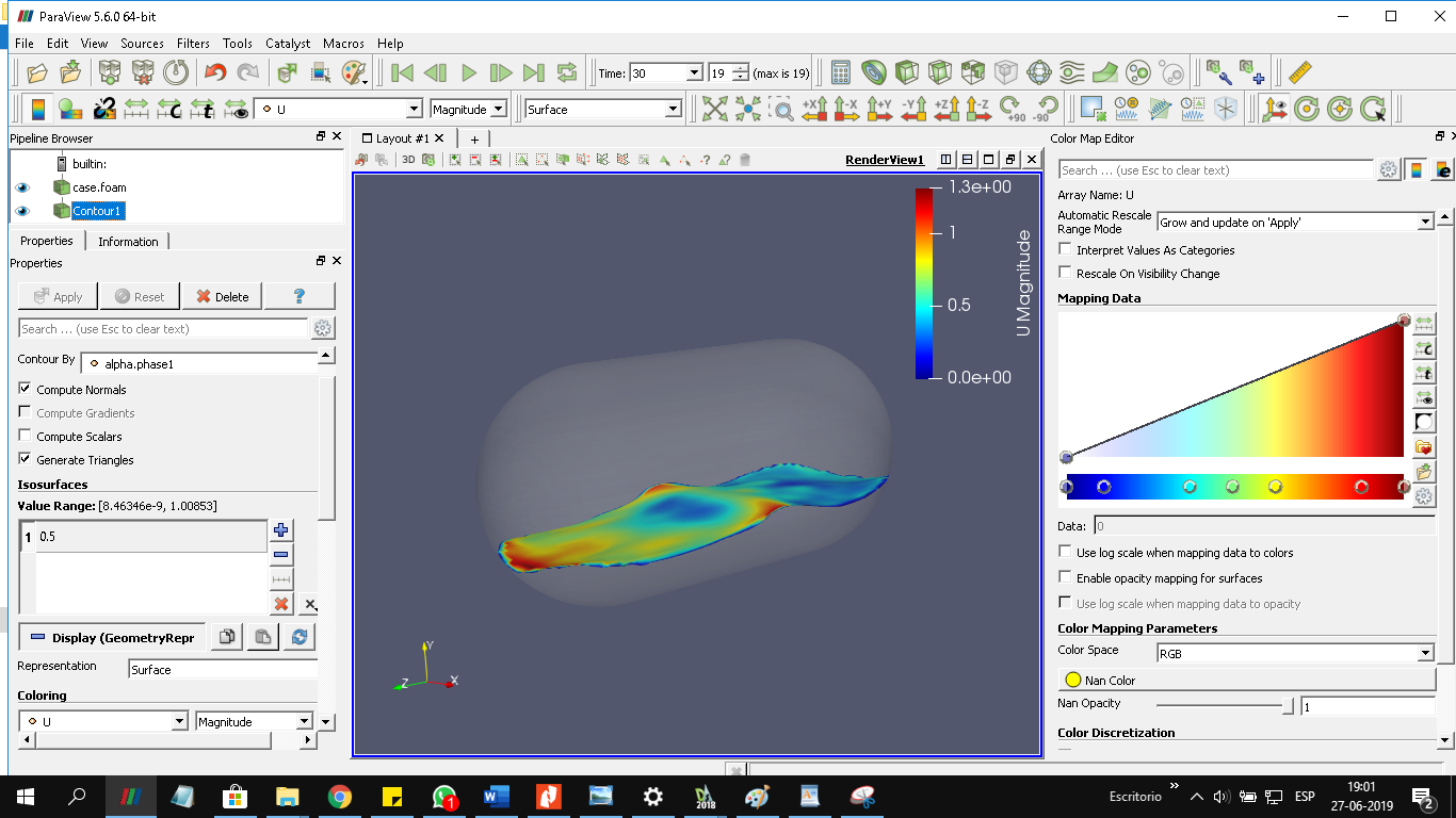

and the post process :slight_smile: in paraview!
saludos amigo @whuaman
To run again do not forget to delete the other folders of the time step of the simulation without removing the folder β€œ0”
