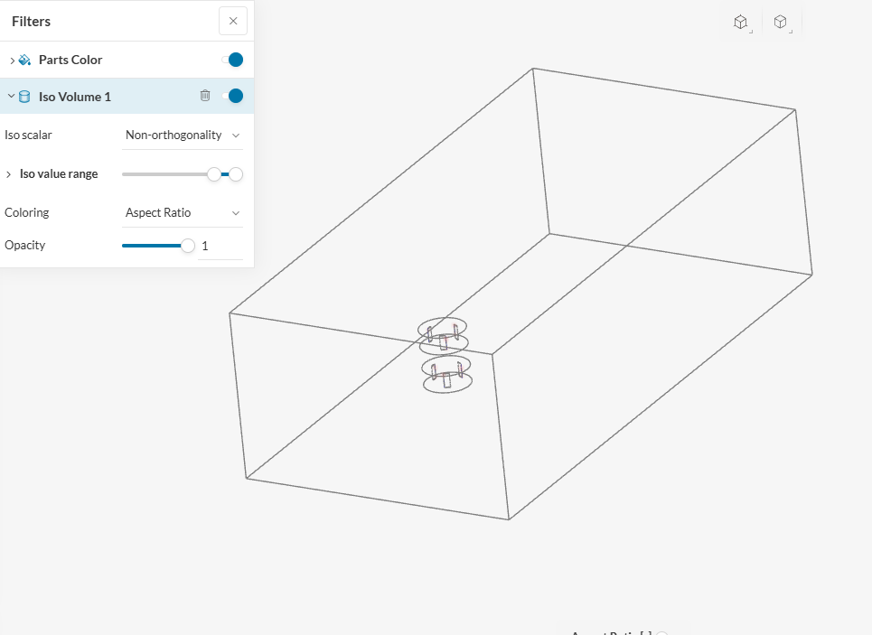

A double turbine (hydroelectric power generation) was simulated under the following conditions:
Diameter = 1m, Height = 0.5m, Blade Shape = NACA0012, Chord Length = 0.2m, Rotation Region Radius = 1.6m, Rotation Region Height = 0.6m
The resulting mesh log was as follows:

What should I do?
Could you expand a bit more on the issue? If you want to lower the max values then make sure to check this page https://www.simscale.com/knowledge-base/how-to-check-and-improve-mesh-quality/
Thank you. I’ll try this.
