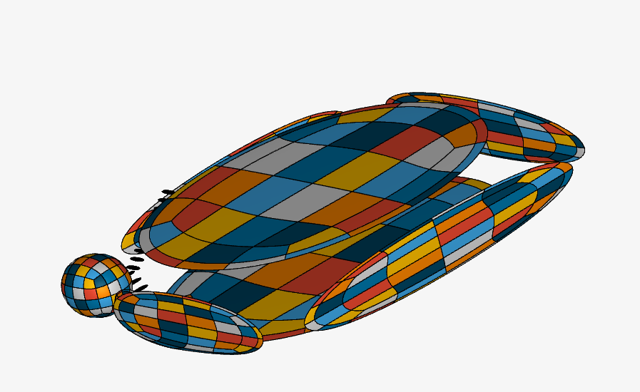

I decided to split it up and get the walls/stairs separated from the rest of the warehouse model I made, after getting that exported, well it doesn’t look remotely close to what I had. any clue why? plus when I exported the other stuff all in one file it said the same thing, I’m assuming I have to upload them individually or separate them. I’ve attached a picture of what I saw, and I also got an error that said “This geometry contains faults and cannot be used for simulation” which I think was a bit too obvious

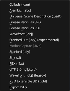

these are my options in Blender, I can remake the model if needed it is not that detailed on purpose, I just am familiar with Blender so I used it
I’ve looked at a couple of tutorials and watched some videos, they all were modeling parts so I’m not sure if this format can export things like this

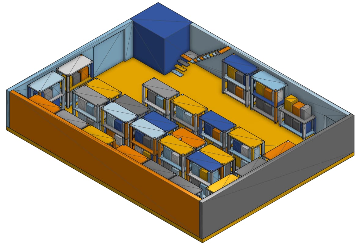

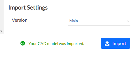

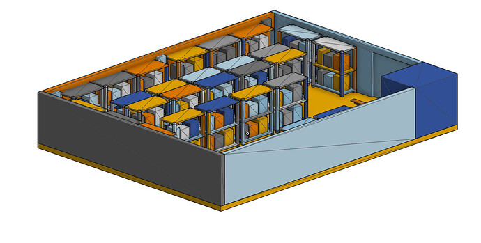

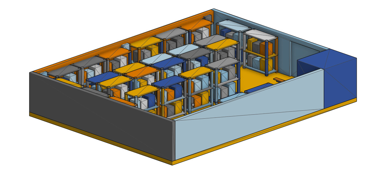

when importing the stl file to onshape it showed up just like in Blender (image attached), I tried to import directly from onshape using the integration thing, and it did let me authenticate and showed me the model however it didn’t show up in simscale, it says I did import it successfully tho, I tried exporting as a solidworks format and that didn’t work either.
I even tried to import it back to onshape to see if the file itself was corrupted and it worked
