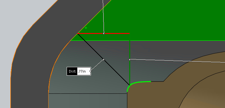

I have a model I am trying to improve the flow coefficient Cv/Kv for a valve moving incompressible water.
I suspect one of the best ways to determine this would be finding the most restrictive section of the path through the valve is.
The flow is not linear so I would want the area perpendicular to the flow. This is easy if I were to be using a regular pipe since that would just be pi*r^2 but this area likely isn’t flat on any XYZ plane like this:
(the black line is the shortest distance from curved surface to curved surface)
Is there any way for SimScale to determine the most restrictive area/section in my valve given my assumptions?
If my assumptions are wrong (likely the second one) is there any other way to determine the most problematic section of my system? There’s a good chance I’m looking at this the wrong way.
