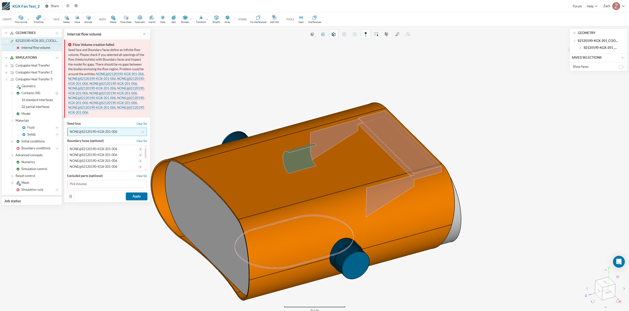

Struggle with the basics of trying to assign the internal flow volume from imported CAD. This is a basic assembly of a odd enclosure with a bottom Inlet and side Exhaust. Internally there are 2 fans in addition to some heat generating hardware (camera and monitor screen). The goal would be to determine effectiveness of the fans to cool the internal hardware in the end. There error I get is either there are gaps or an infinite flow region depending on the Seed face I select. Any guidance would be appreciated as I know I am way off. I did go through Tutorial 2 before attempting to set this up. Thanks all

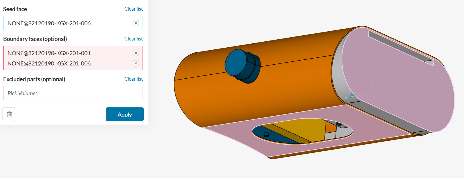

The seed face that you selected should work well, but the boundary faces should be only these 2 in pink:
Boundary faces cover the openings in the CAD model, so there are only these two.
@RicardoParis ahh I see my error and misunderstanding now. Thanks for pointing me in the right direction and quick help!
