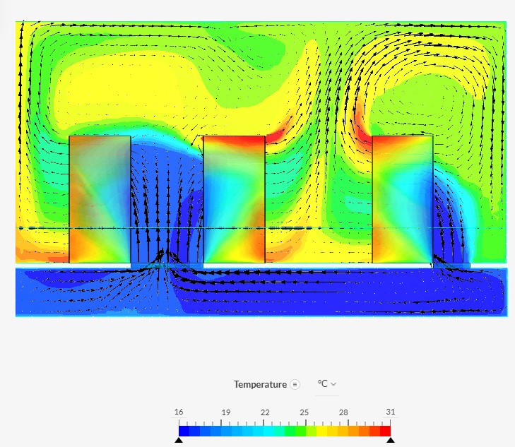

I’m currently simulating different containment strategies for data center cooling. I successfully developed the open aisle model, and it seems to be working quite well:
Now I’m working on the Cold Aisle Containment (CAC) configuration, which involves isolating the cold aisles to prevent hot and cold air from mixing — a phenomenon clearly visible in the open aisle case.

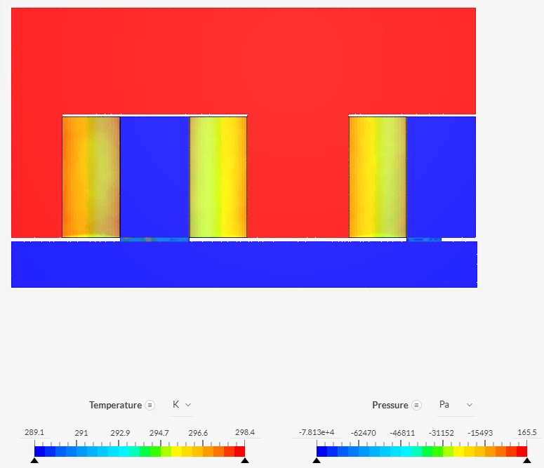

I’ve used the same boundary conditions for both simulations. However, in the CAC setup, I’m getting very strange results:
A massive pressure differential develops between the aislesAir speeds exceed 60 m/s (???)
The direction of the pressure gradient looks incorrect, especially considering that the supply air is coming from the underfloor plenum
Here’s an example of what I’m seeing in the CAC simulation:
I’m honestly lost at this point. Has anyone experienced something similar? Any ideas on what might be causing this would be hugely appreciated.

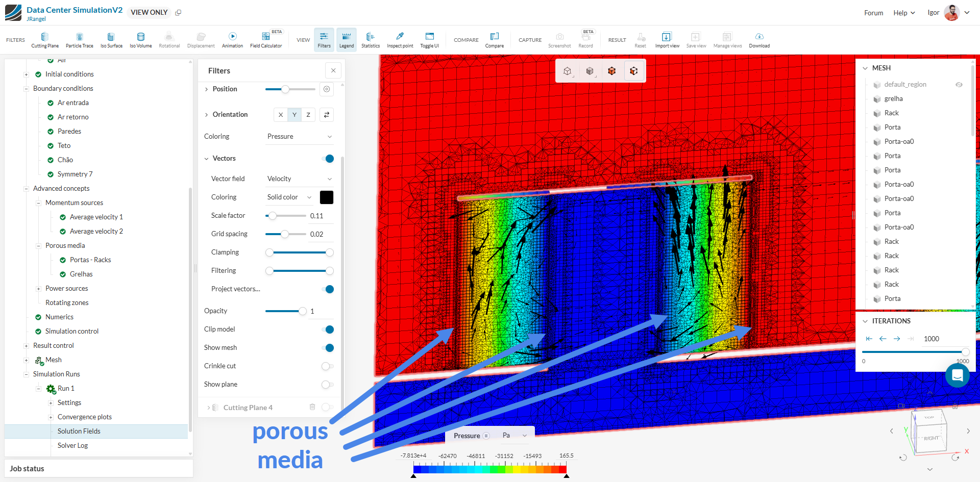

Link to the project: https://www.simscale.com/workbench/?pid=2279780503123522622 (“Data center Simulation V2”)
