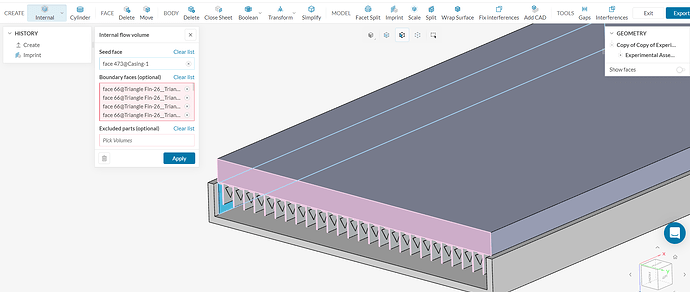

Hi currenly i am having on selecting the boundary faces, in which many times i tried but. In the model, it have an extra area for the casing in front of the fin for me to put the air in real experiment. But when try to do create flow region it is qquite hard due to the extra area of the casing.
Link to my project: SimScale Login

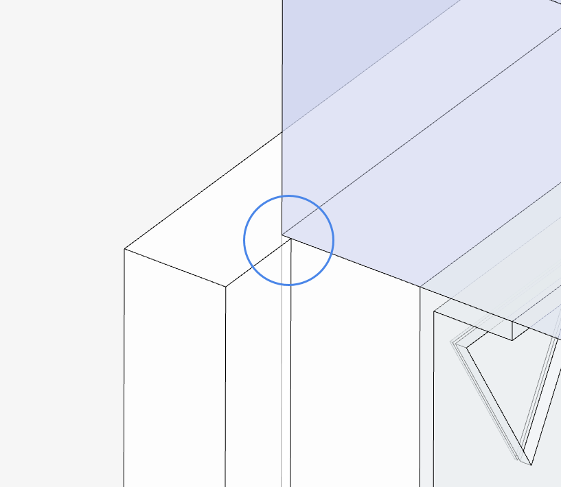

I think there is a gap in these corners, make sure they are in touch and that the joint is not only a line:

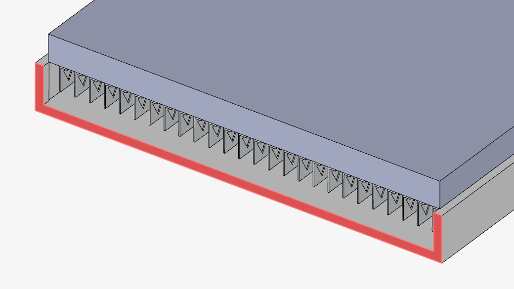

The protusion of this face will cause problems when picking boundary faces. My solution was to cut it to make it flush with the other ones:
