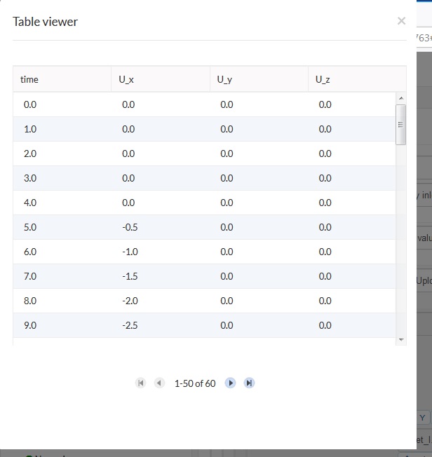

i think you need a csv file like this, or you use a linear funktion ?

He is right @damiduz, you can either use a CSV table upload or define a function (f(t,x,…)) to prescribe time dependent BC. Let us know if you have any further questions!

I think a linear funktion y=mx+b, (1/3)(x*t),x=1 so you got a linear funktion from 0 to 100kmh in 300 seconds (5 min)
