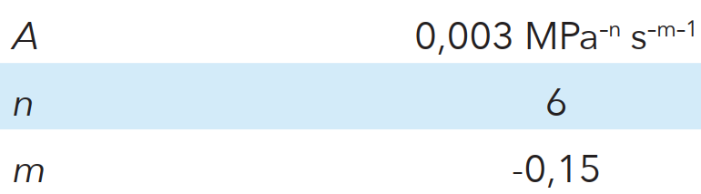

I want to define creep using Bailey-Norton law. I found material parameters in literature for the parameter A given in units MPa^(-n) s^(-m-1). Could you please help me how to convert the given value for A to the SI units? The values are shown in the attached figure.

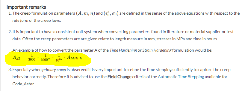

Hi @aaasimm
Have a look at this, is this the same you are asking for.
Regards

Thanks Hamza! Yes I was looking for this.

I think the key is to know the units of A. For Strain hardening case, the units of A are as shown below.
