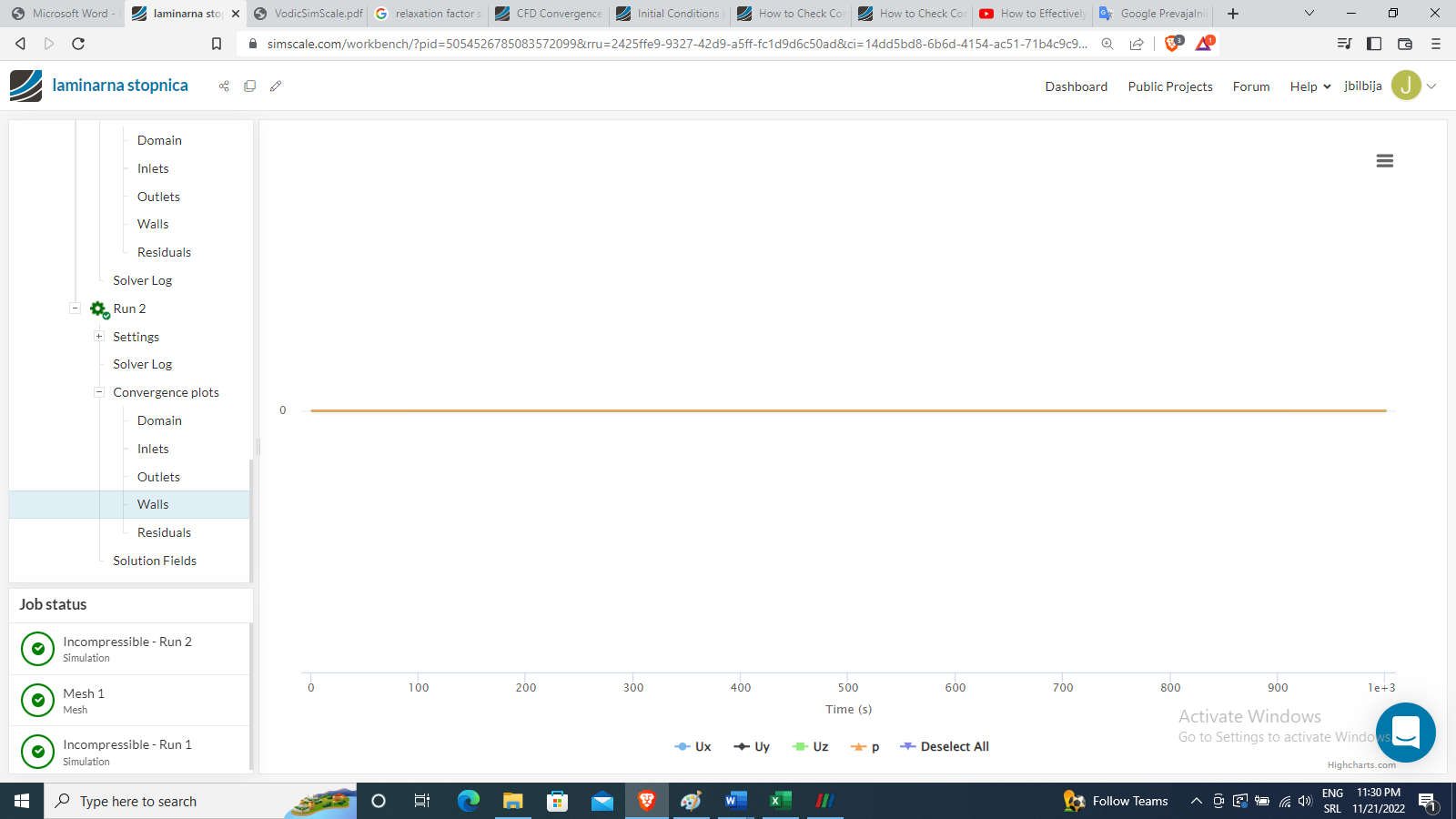

Greeting! I have a problem with convergence. Namely, the diagrams should not look the way they currently look for me.
Can someone help me how to solve the problem?

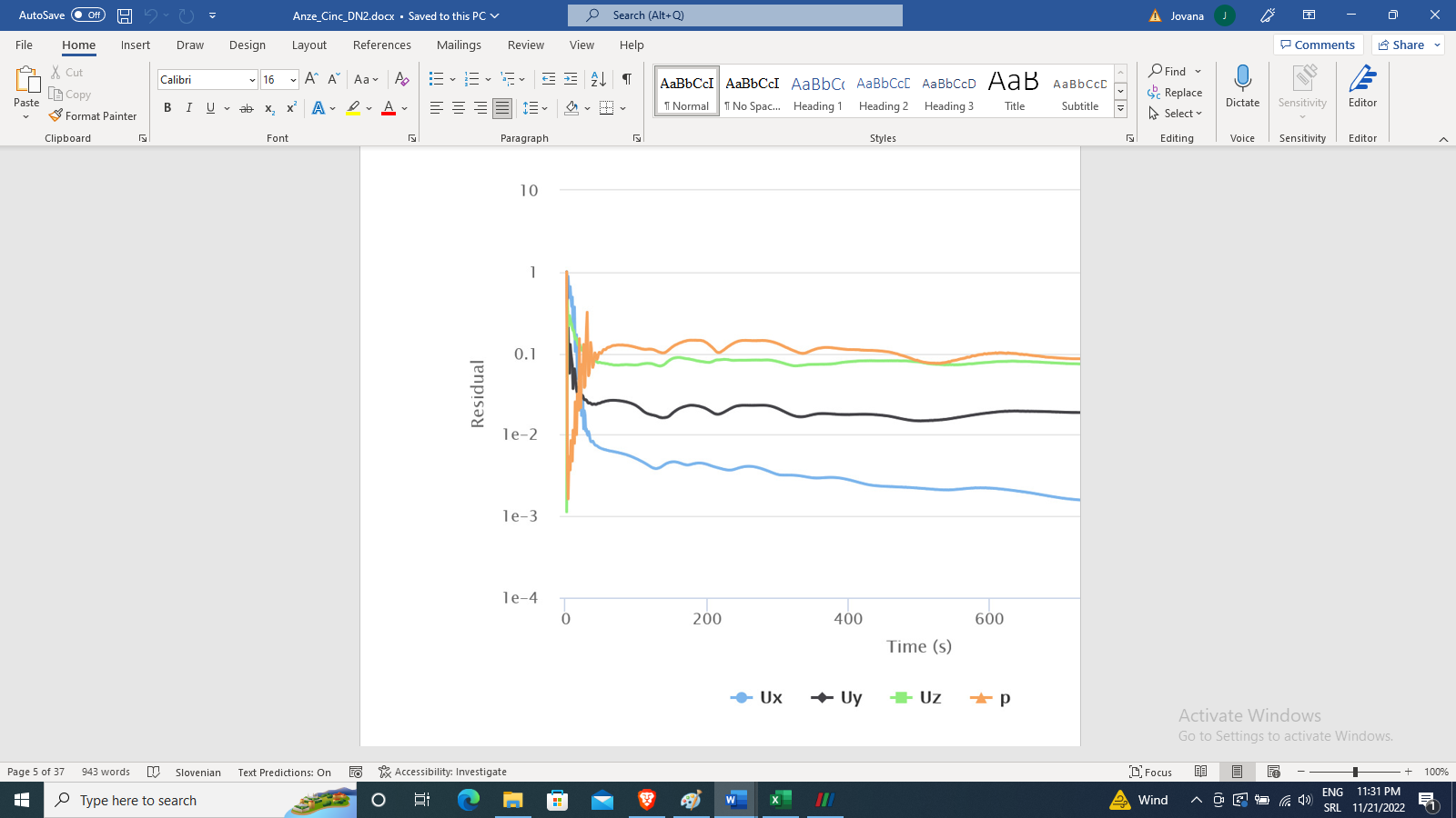

This is what I have, and it should look like this.

ich have taken a look at your mesh and it seems like the inlet and outlet face was lost during the meshing process. Therefore no Air was able to enter or exit the fluid region.
Please investigate the mesh around this area.
One option could be to apply a surface refinement on the faces to ensure that the level of detail is applied.

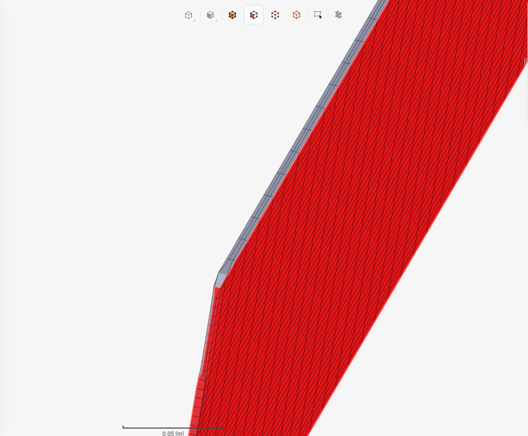

I made a new project and mesh and now it seems to me that the inlet and outlet are still there?
Thank you very much!
