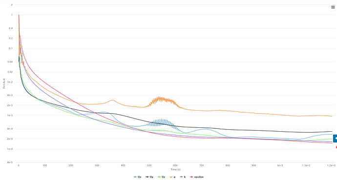

I’ve completed a simulation about a Rearview Mirror (Turbulent Regime) and I would like to know if it is possible to plot the continuity residual. If yes, how can I do it?

unfortunately, we don’t plot the continuity residuals. You can check the values in the course of the simulation, look for something like this in the log:
time step continuity errors : sum local = 4.98893e-05, global = 1.58819e-20, cumulative = 7.4834e-21
On the positive side, we are working on a more elaborate way to monitor convergence. Then, you will have more control over quantities to watch.

The Simscale workbench provides the converge plot for every simulation. If you asked for something else then please elaborate.

This thread has started with question whether it is possible to plot continuity residual, I was looking for the same residual in my simulation however I didn’t find possibility to plot it.
I’m looking for continuity residual and option to set my own point or plane to measure residuals.

So there is actually nothing planned for the continuity residual, just to keep you updated on this one. Let me know if you need any additional help or have questions!
