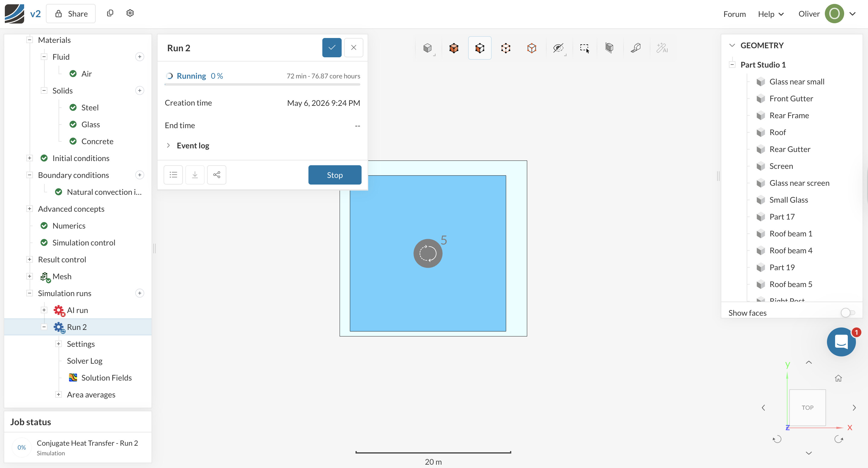

I am trying to complete a Conjugate Heat Transfer Simulation.
The simulation is stuck at 0% and not moving, I can see in the log that T=1, this has not increased.
My project is shared with support
It appears that the project is either not shared or it has been deleted. As a suggestion: look for regions in the mesh with high cell density, as they can indicate small gaps/small faces in the CAD model.
