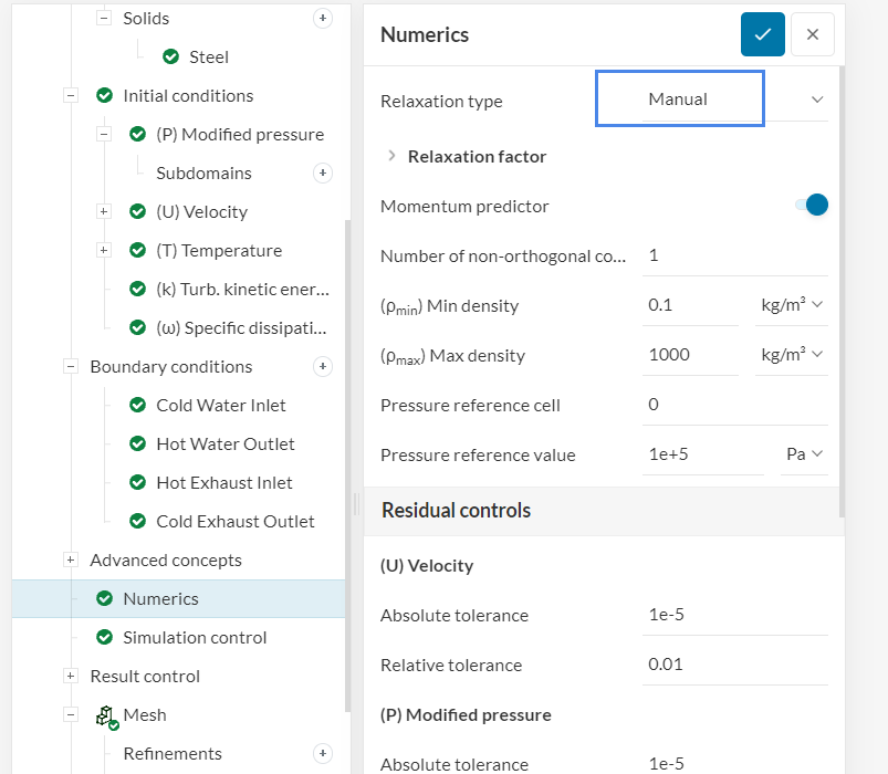

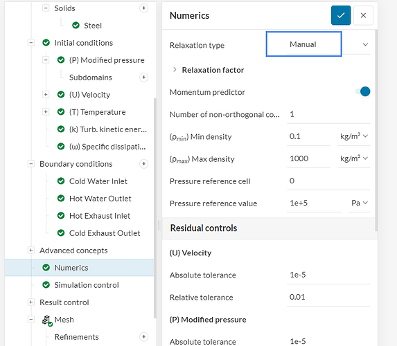

At a first glance, the issue with the failed simulation is the relaxation type under Numerics - I’d suggest trying “Automatic” here:

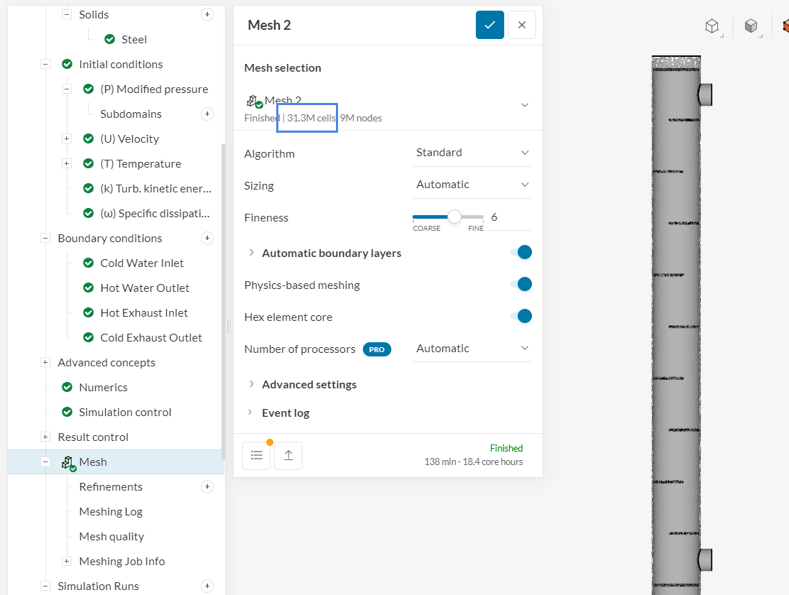

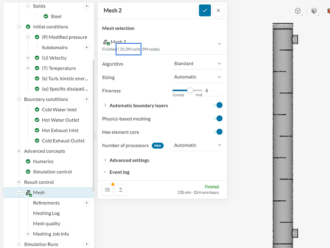

PS: it would be a good idea to use a coarser mesh. The current mesh has more than 30 million elements and it probably won’t run all the way until the end, given the community plan runtime limitations.
