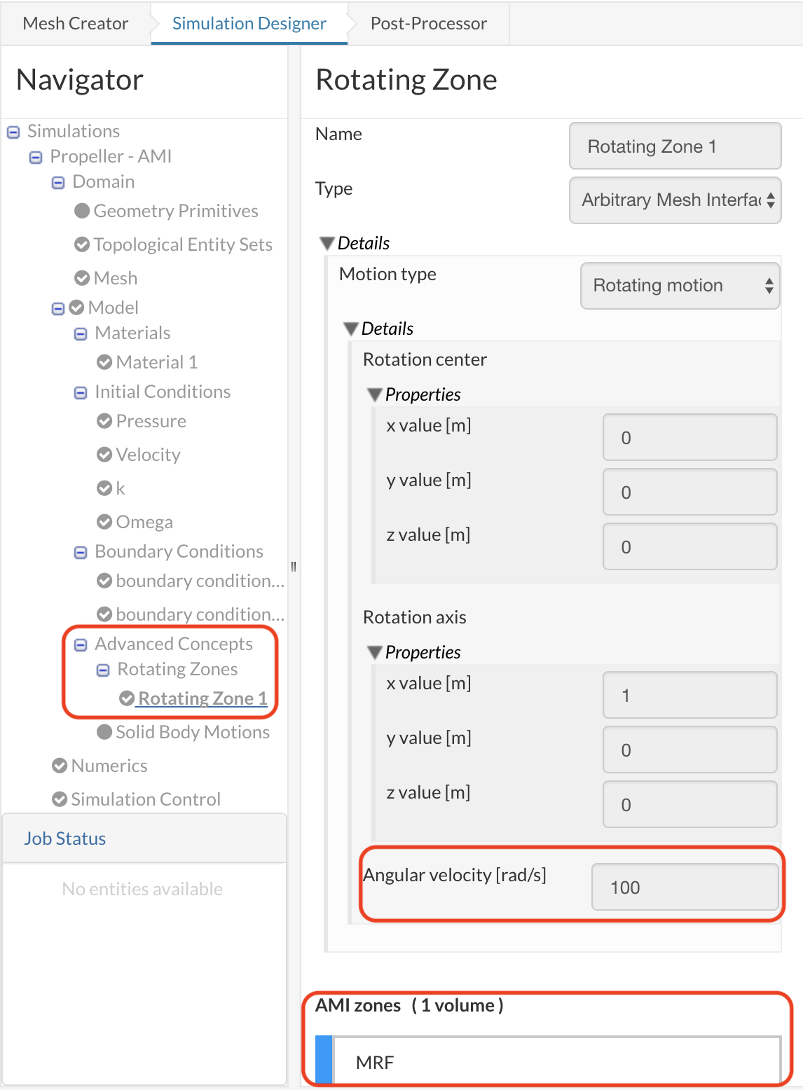

Hi Darren
Where do I go to input the speed at which the propeller blades turn? Like for example I have to do it for 3 different RPMs- 3000, 4500, 7500. Could it be under ‘boundary conditions’?
Melissa
Hi Melissa (@msheu)!
First of all sorry for the delayed response! Attached you will see where to define the rotation speed of the propeller. Note that the speed is given at [rad/s] so you would have to convert your numbers [rpm] first.
Hope that helps!

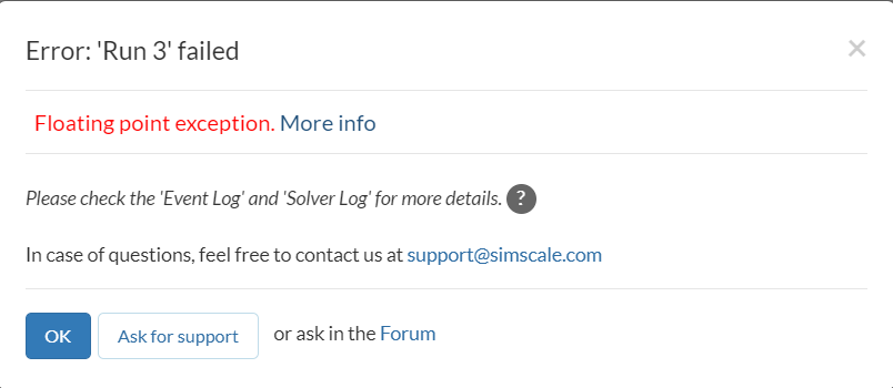

Hi @jousefm
I’ve defined the rotation speed of the propeller in rad/s and have followed what you’ve said earlier but unfortunately I’ve encountered this error message
Any ideas?
Melissa
I’ve specified a non-zero value under custom boundary conditions for the velocity in the x-direction but I still received the Floating Point Exception error message.

Hi @jousefm
Before that, I didn’t define the rotation axis which gave rise to the floating point and solver log errors.
Melissa
