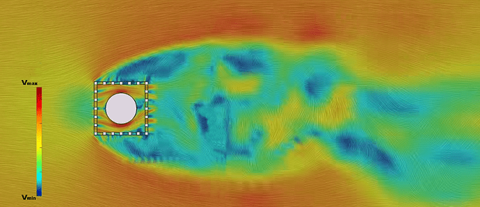

i need help with a simulation of a floor-cut-out from a building. I am new to simulating in general and also with simscale.
I try to achive a wind-simulation of the cut out floor. So it could look like this:
But when i try to simulate i get an error everytime and i dont know how to solve this problem.
Would be nice if you guys could help me with that.
