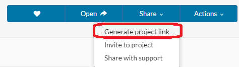

No problem @malik12985!
Could you share the link from your project? Simply post your link as a reply and I will get back to you as soon as I have a solution.
How to share a project:
