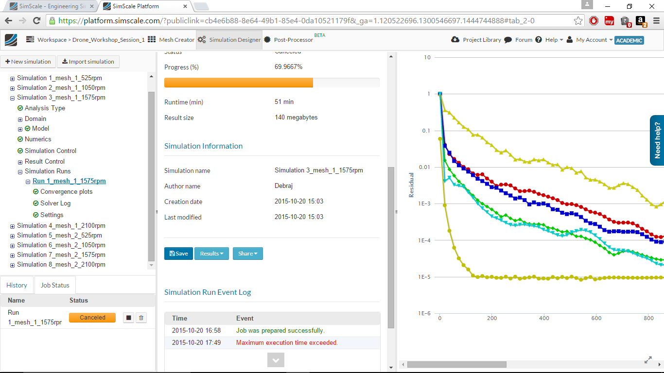

I am facing a problem while running the simulations. It just get cancelled every time. Here’s the screenshot and the public link of the project.
https://platform.simscale.com/?publiclink=f52c9f90-cd25-44c1-93bc-5f3468728f62
In Simulation 3_mesh_1_1575rpm you have default Maximum runtime set at 3000 [s]. Change it to greater value and it will be ok.

@Maciek Thanks for the help.
