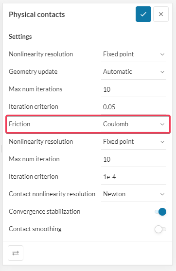

Friction can added to any physical contact. Physical contacts imply that we are already in a non-linear analysis scheme.
First activate the non-linear analysis toggle
Then ensure that there is at least one physical contact defined and set Friction behavior to Coulomb

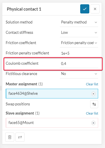

Friction is enabled, and you can now edit the friction coefficient through the specific physical contact settings.
