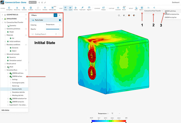

As an example, the simulation below depicts a thermal analysis of an oven where multiple fan settings were tested. The simulation below is the outcome of when two fans are working. We can see already that there are multiple filters defined here in the post-processor, and we would like to copy them to the simulation of the model where the two fans not working.

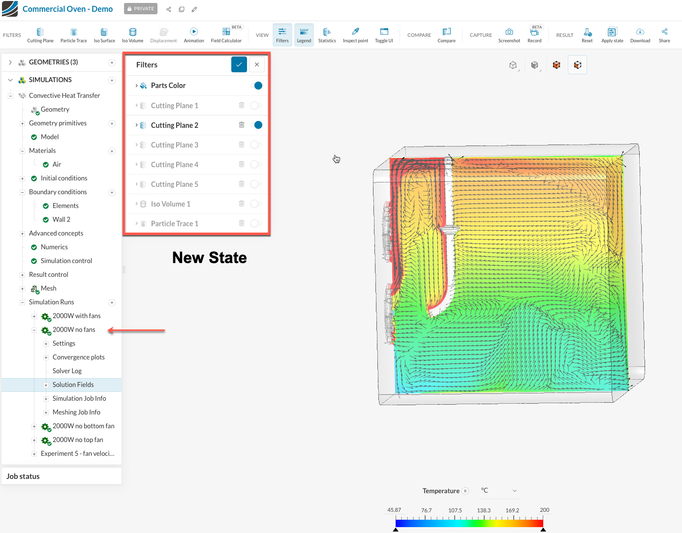

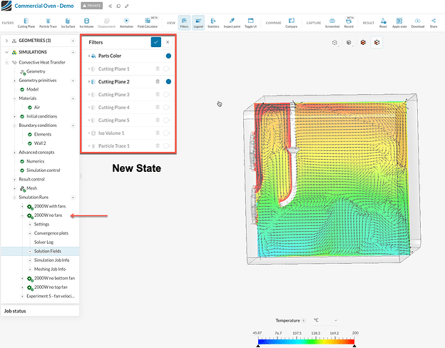

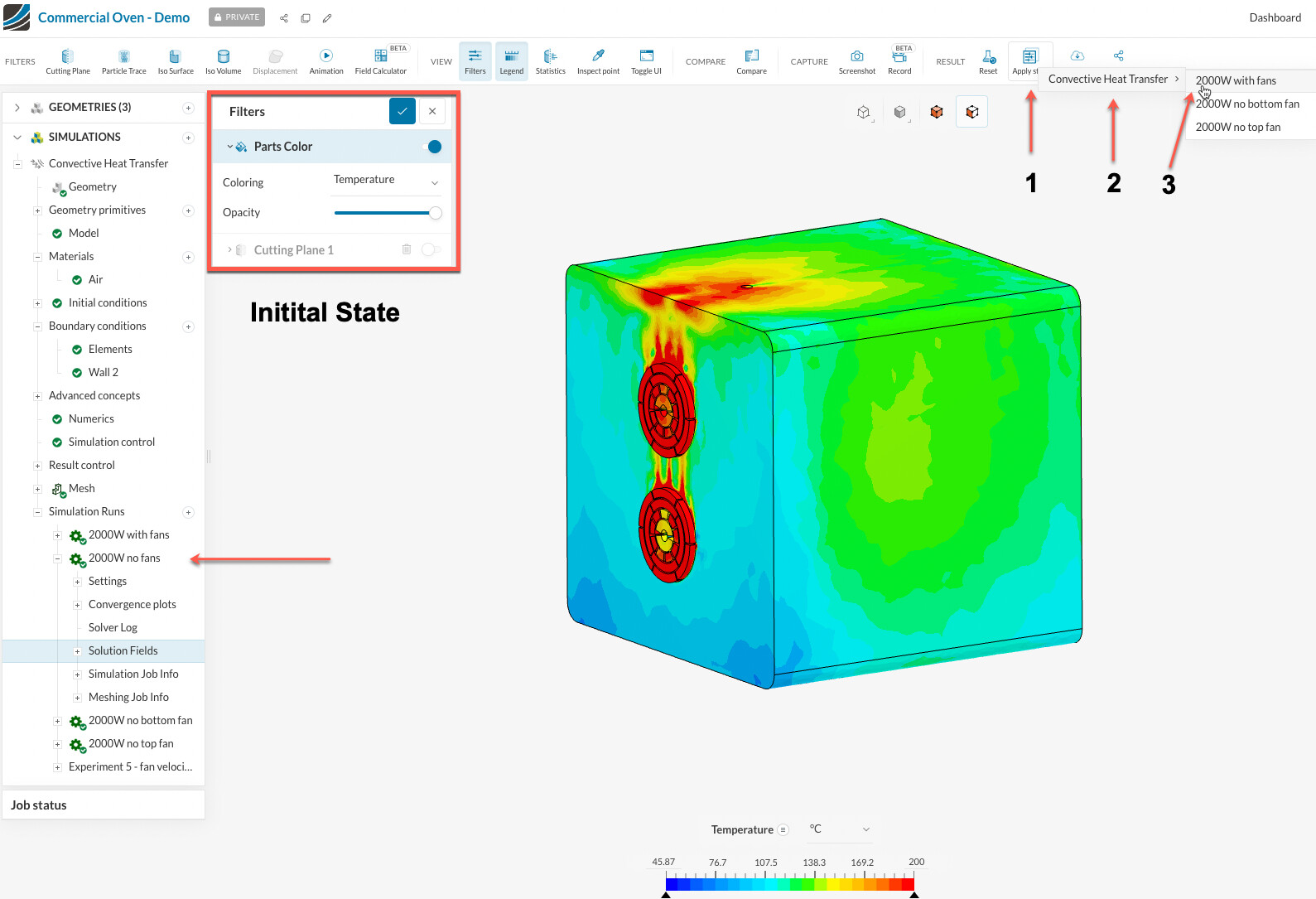

When opening the results of the simulation with the two fans not functioning, the clean post-processing state would be as shown below. In order to apply the filters already created in another simulation, you can the following:
- Click on the applicable state button
- Choose the simulation
- Choose the run that contains the filters you want to copy
