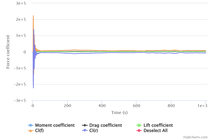

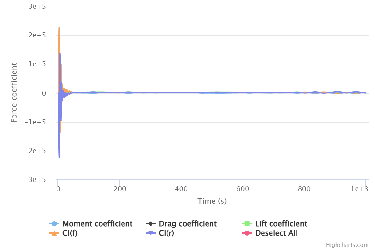

Here are some graphs and this is a file to the project. The drag coefficient seems wrong. Please help.
Hi David,
There seems to be a wrong setup of your coefficient report. Most important the reference velocity should be 44.4 m/s (100mph). Please have a look at this page on how to setup the coefficient reports.
Sebatian
