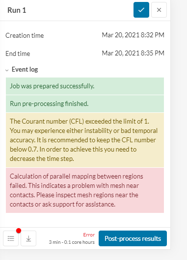

I’ve created a transient CHT simulation. It try to simulate the heat transfer in a mould where a cooling water tubes are added inside. I want to know why when I run the simulations a error appears saying: “Calculation of parallel mapping between regions failed.” I’ve changed the mesh setup and the refinements but it still appears.

For CHT simulations, you should use the Standard meshing algorithm, which has a lot of optimizations to avoid this and similar errors.
