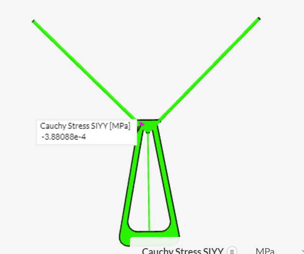

I would like a range of data points of the von mises and different cauchy stresses (about 30 points each from different areas of the model) and am currently manually selecting a point and writing down the value. I was wondering if there was any way to automate this, either by being able to select a section of the model and there is a setting that provides data on each mesh point in that area, or anything else.

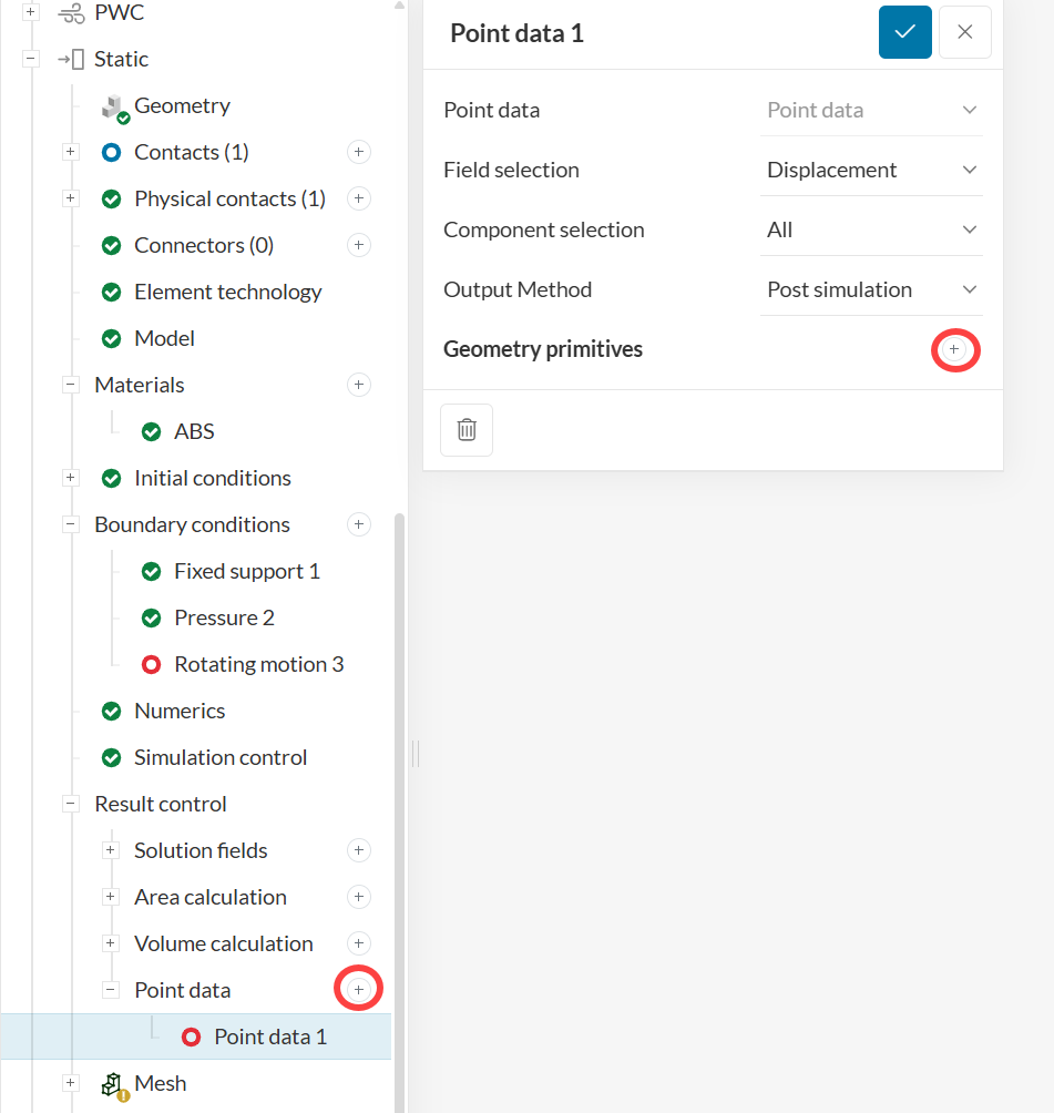

From your description it sounds like you’re interested in creating probe points. This can be done under result control > point data.

Hi @nditta - quick retraction - I guess if you created a single probe point result control and assigned different points to it, you could download the plots as a single .csv file.
