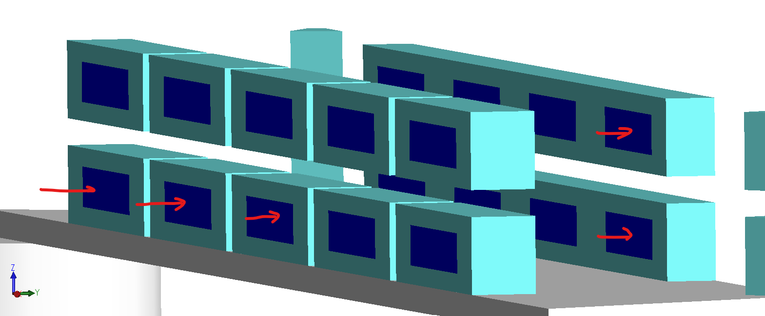

In the screen shot of the CAD model below, air will flow from into each porous zone (shown in dark blue), in this case in the positive y-direction. This entrance region on the dark blue zone is the region I wish to measure an area average result control.

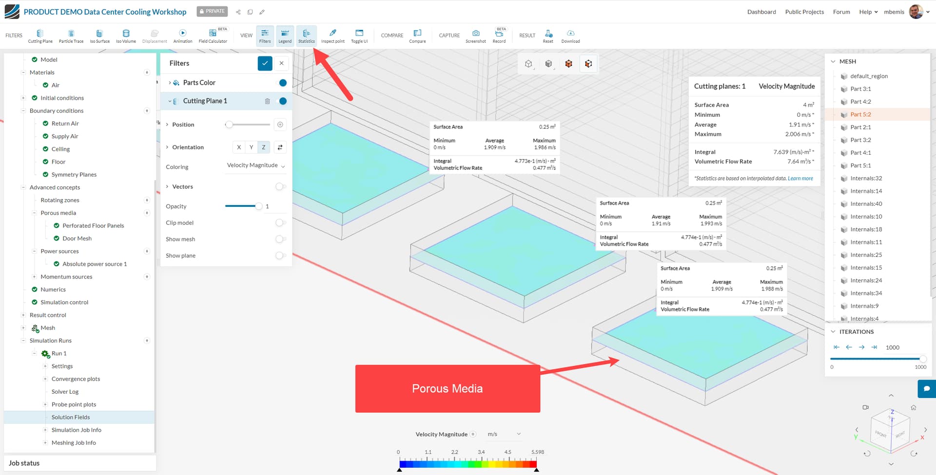

Here is an example of measuring inside porous media using a cutting plane + statistics filter in the postprocessor:

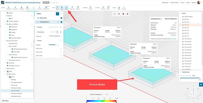

In order to extract other results, you can change the active field on the legend bar, and then the Statistics field will pick it:
