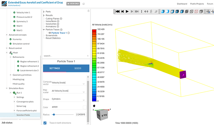

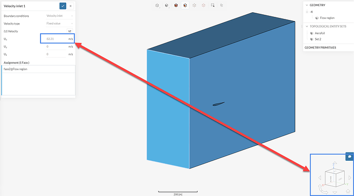

Hello there, I am having this issue with the airflow in my simulation. It seems to move weirdly. How to fix?
Project-

Hey there!

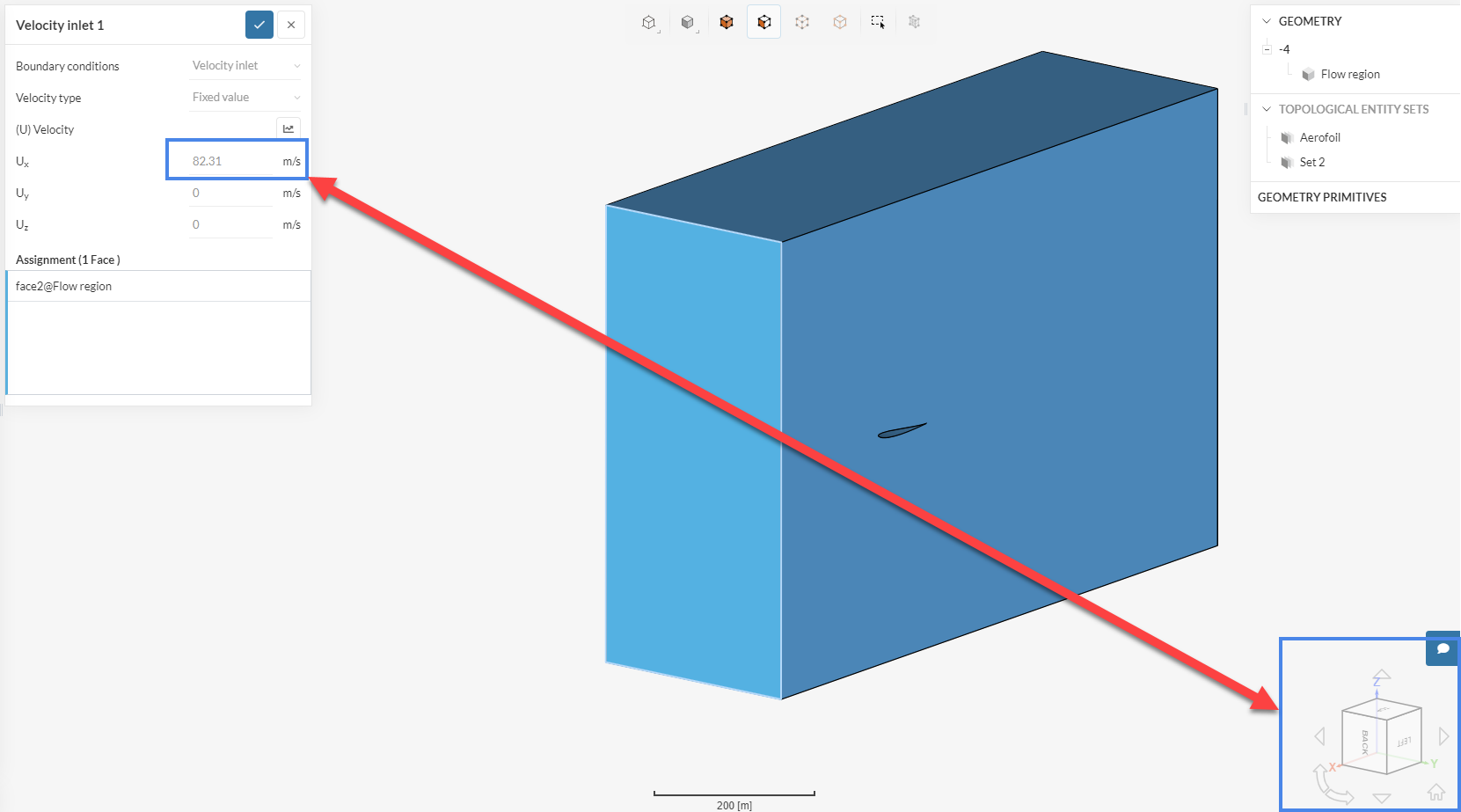

To begin with, your inlet velocity is pointing out of the domain.

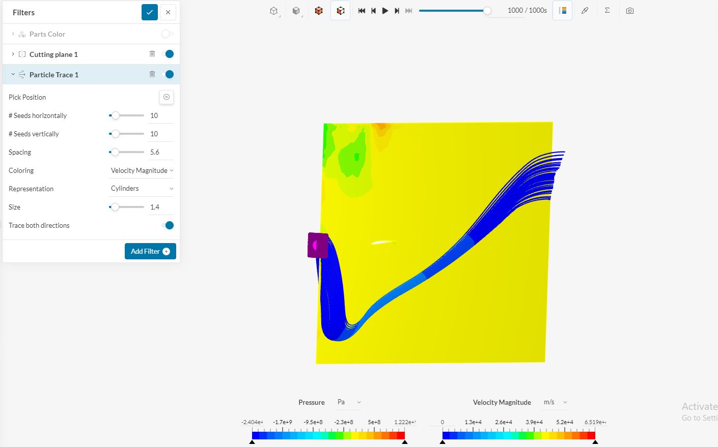

The other boundary condition that is wrong is the bottom moving wall. Is there a reason for it to be this way? Otherwise just change it to a slip wall, just like the other lateral walls.

thank you for pointing that out, how do I make it flow inside the domain?

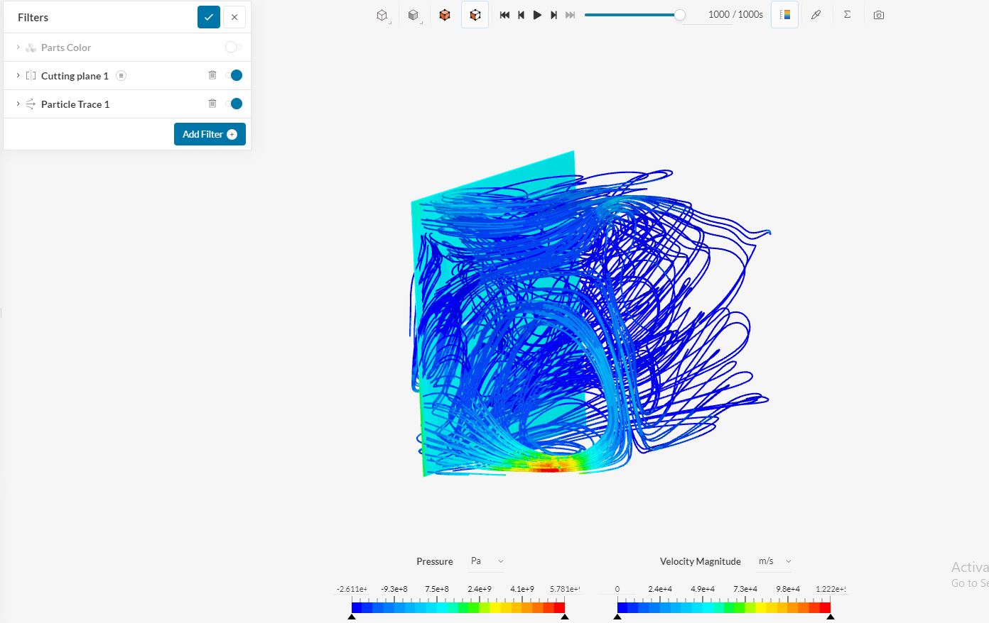

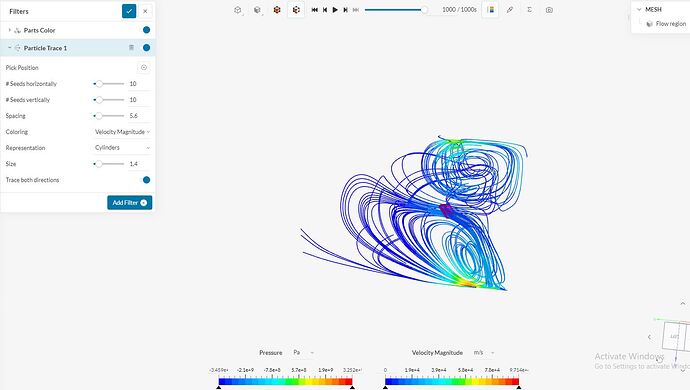

Make the enclosure much bigger to avoid the effect from the walls.
