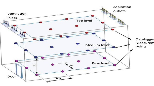

The model can be created using the geometry dimensions provided in [1]:
The above image shows an overview layout of the room.
  • For complete details please refer to the paper.

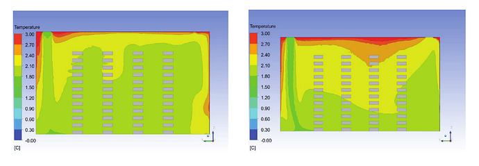

The purpose of this study is to validate the the solver for indoor air-conditioning and ventilation with the experimental data presented in the paper. The measured data at several locations and levels is to be compared with calculated values to give a good ideas of the spatial distribution.
A sample Temperature distribution image.
