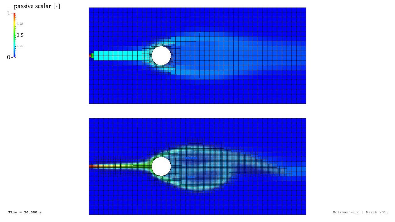

Hi, I went on a course recently and the topic of adaptive meshing was bought up. I know people usually say when with be available bla bla. Can I just say id be very interested to see this bought to simscale, at least for steady state first? I found this video which looks like what I have in mind (and it happens to be open foam)

And as a side note, I think the video you posted here is from @TobiasHolzmann, right Tobi?

@dheiny, yes you are right. It was simulated and tested by me. The only problem we have in 2D simulations here is the fact that the hexRefiner works for 3D only and hence (even we simulate a 2D case) we get a refinement in the direction that is marked with empty. The only way to resolve this problem is to build an own library that refine only in two-dimensions.
