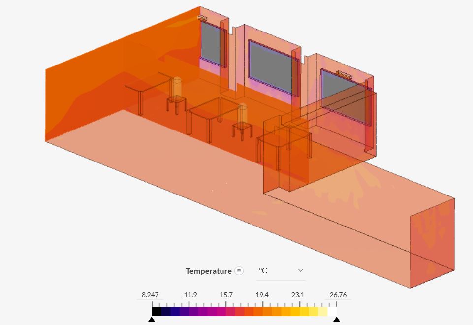

I recently used Convective Heat Transfer Analysis in Sim Scale for my class project. Thanks to Sim Scale supporting team, the simulation went well. But now I want to know the background process of this simulation, which means I want to know what kind of equations and methods are used for this simulation. If it is possible I want to calculate the theoretical value of this project and compare it to my simulation results. So in short if there is such an equation, is it even possible to calculate Predictive Value of the Analysis using that equation?
