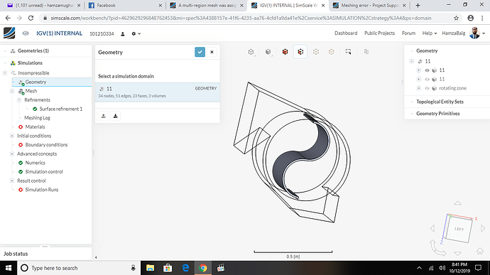

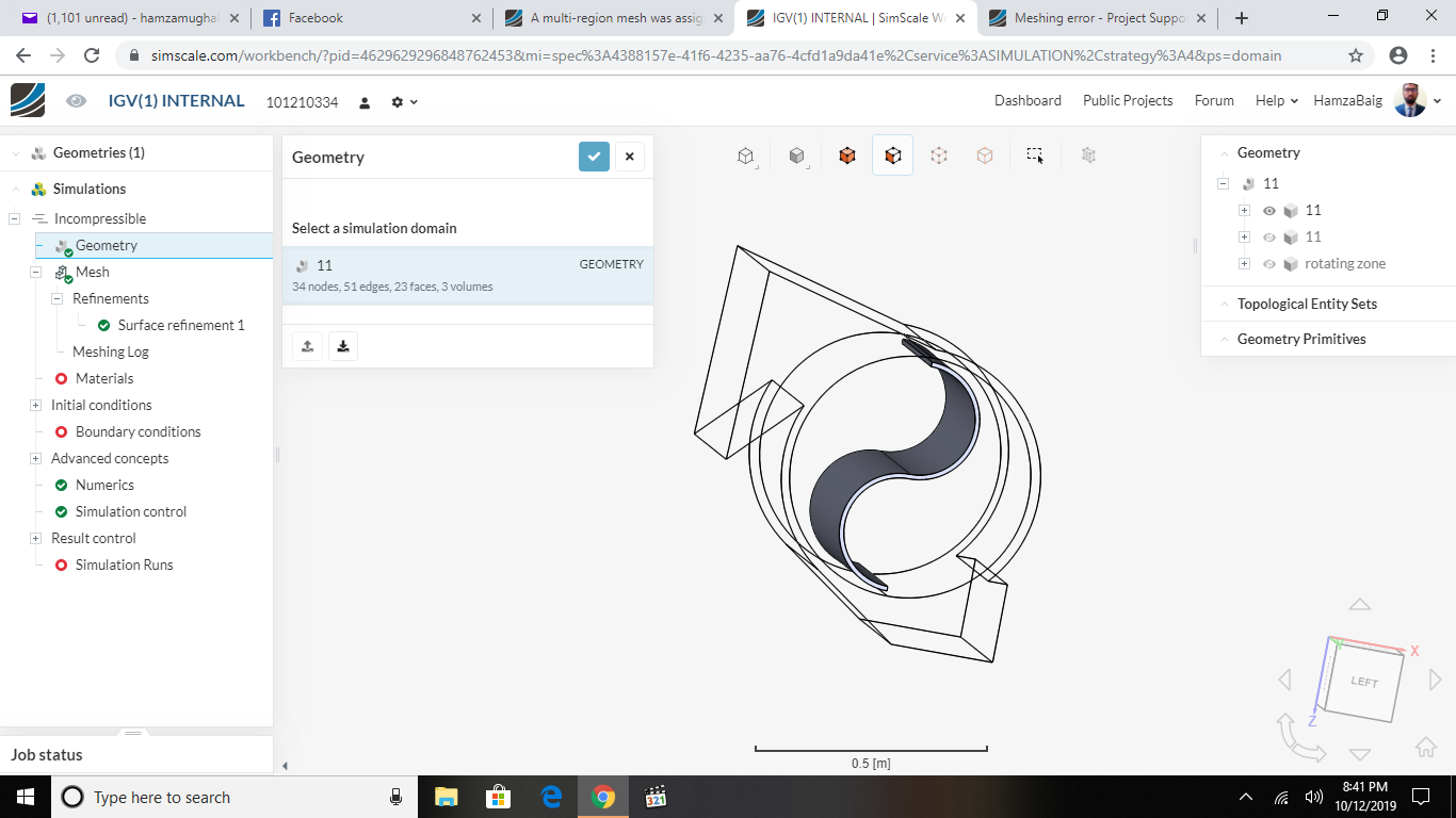

A multi-region mesh was assigned - this analysis-type requires a single-region mesh
When I was doing Internal CFD, after meshing, and error is shown
A multi-region mesh was assigned - this analysis-type requires a single-region mesh.
How to solve this problem?
project link: https://www.simscale.com/workbench/?pid=4629629296848762453&mi=run%3A1%2Csimulation%3A3&mt=SIMULATION_RUN
You have to subtract the turbine blades from the model for simulations. You need to replicate the fluid flow domain in your CAD model and then go for meshing.
