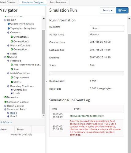

here is my error msg.

Hi @akpcorp,
whenever you see the error of projecting a field because of an empty node list, you should check your contact faces - usually it points to a wrong master/slave assignment (slave and master being far from each other).
I guess in the meantime you solved this.

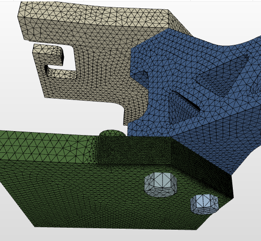

Regarding your current convergence issues, I think they are related to a poor mesh on the physical contact region on the bottom side. The refinements are put onto the wrong faces:
Richard
RIchard, thank you very much for the clarification!

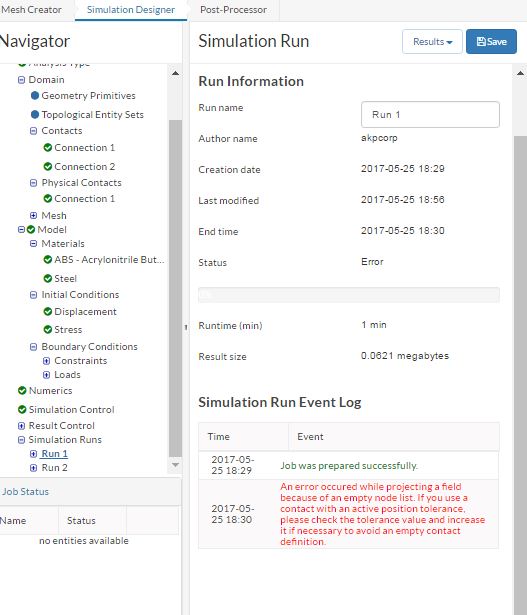

The solution matrix is not factorizable. This might be caused by an unconstrained rigid body motion or by overconstrained degrees of freedom due to multiple linear relations at at least one node.
I need help to resolve this error.
