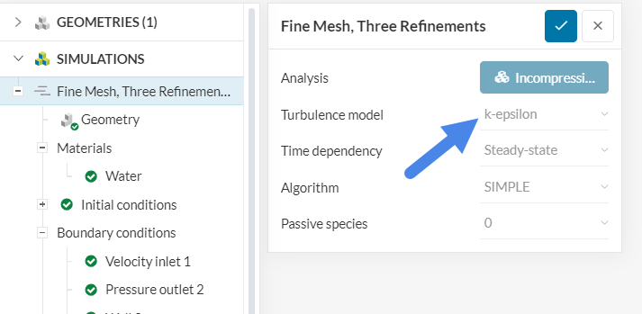

Hi all! I am very new to SimScale (and CFD in general) and am trying to create a simple setup of water flowing past a sphere. When I run this simulation, I find that the drag coefficient does not match up with what is expected (I have tried flow rates that correspond to Re values ranging from 0.1 to 100000). Right now, I am using Re = 100, and I have tried making some modifications to the mesh but those changes have not changed the results. Does anyone have suggestions for things I should try modifying to get the correct drag coefficient?
For reference, with the current input flow rate, the expected drag coefficient is 0.993, but the simulation converges at about 1.10.
