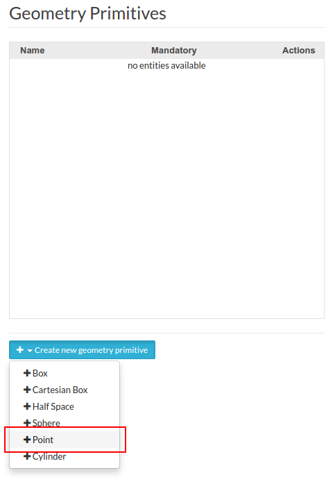

You are able to create Points under “Geometry Primitives”.
In the next step you define the coordinates of the point(s) along the rod.
Under Result control in the Simulation Designer click “Add point data item” and chose the desired field (in your case displacement).
You can see the displacement plot in the post-processor and you are also able to download your plots in different file formats.
