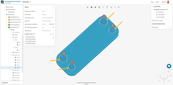

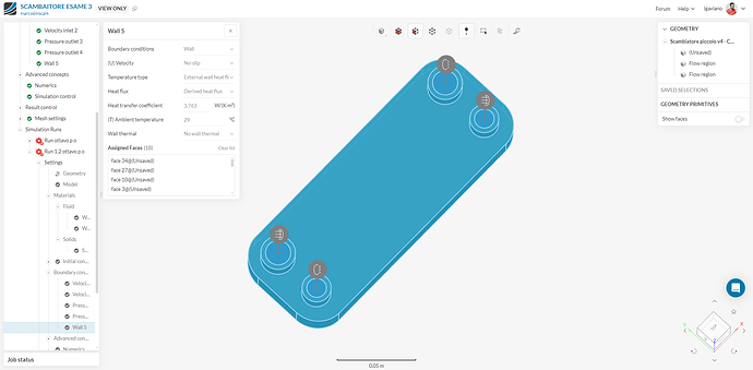

I think there’s one extra change from the successful/unsuccessful runs.
On the successful run, these faces are unselected:
Whereas on the unsuccessful they are selected:

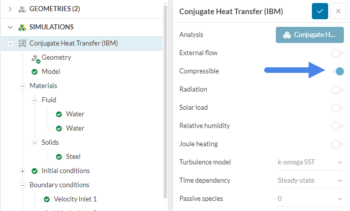

Maybe trying to change this and rerunning the simulation is a good first step. I’ll also ask you to try and reduce the amount of core hours you’ve been using on your simulations - this will lead to less computing resources being spent and the simulations being run faster. One thing that might be helpful is setting the compressible option to off:

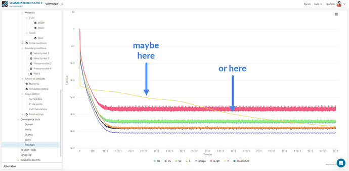

And also reducing the number of iterations by stablishing an acceptable tolerance value:
