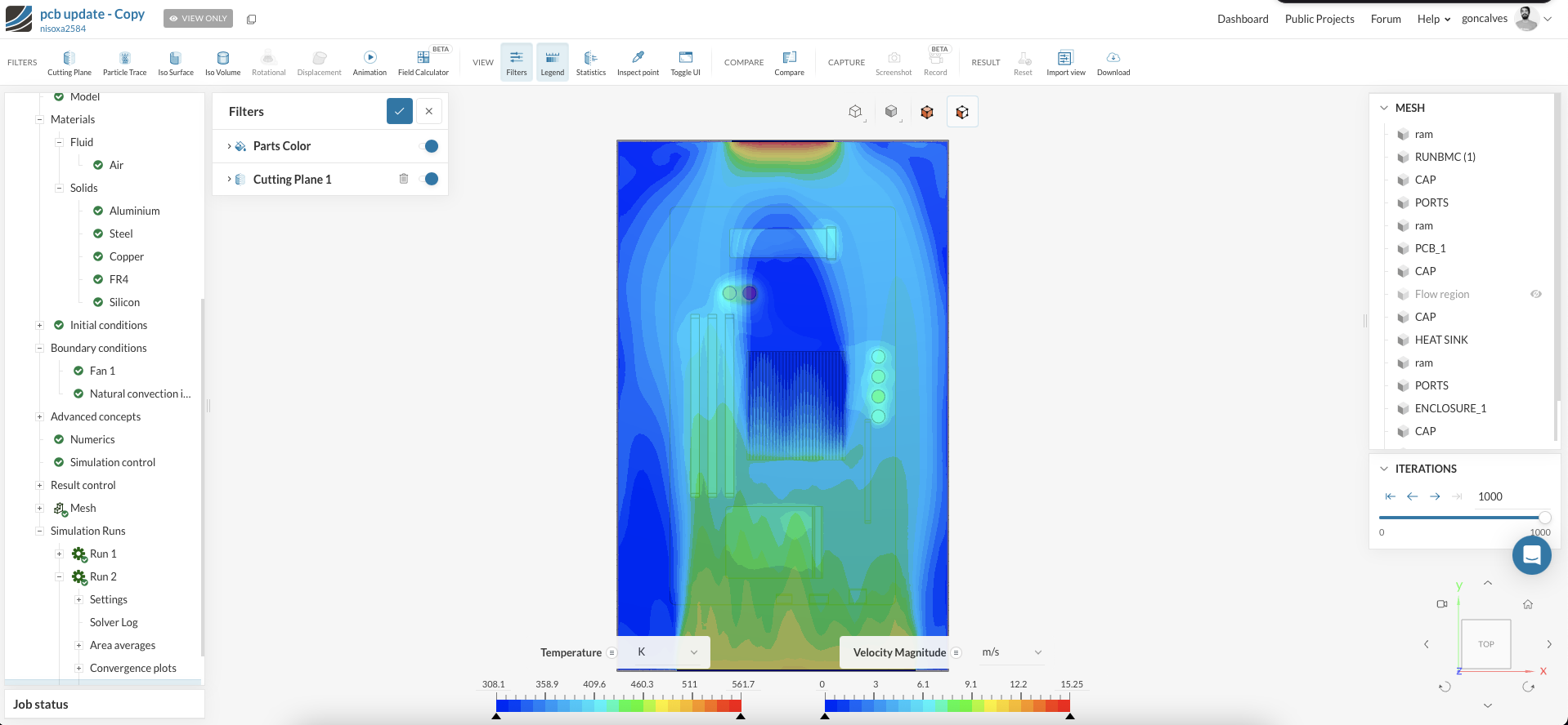

getting very high temperature at capacitor please verify where i am doing mistake and temperature difference between inlet outlet is also very low i,e. 1.5 degree kelvin
this is my project link https://www.simscale.com/workbench/?pid=7946213188351180971&mi=run%3A76%2Csimulation%3A69&mt=SIMULATION_RUN
Hi @nisoxa2584,
Again, as in your latest project I see that the high temperature value is in the region with the lowest velocity, which is completely fair.
In this case, for this configuration and considering your boundary conditions, I do not see any problem.
The suggestion in the previous post is still valid for here as well.
best,
