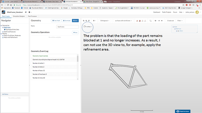

For several days the loading of the part, in the 3D view, is not done correctly.
I made up the problem via chat, however I can not find the conversation to get information, have you been able to correct this problem?
here is the link to my project:
Thank you in advance,
Julien
Hi @julien_venture!
Could you share a screenshot to get a rough idea of what the problem is? I will see if I can reproduce the error.
Hi @jousefm,
Below an image with more explanation :
Hi @julien_venture!
Already contacted my colleagues and will try to give you some feedback as soon as possible!
All the best!
Hi @julien_venture!
Can you try re-uploading your geometry (best would be to create a separate project) and see if the problem vanishes?
Thanks and cheers!
Same thing happened to me 2 days ago. This is due to may be some server side issue so I could not use Box Assignment Tool. So what I did is I selected the 18 Faces from the list. The only problem in the whole exercise is the Box Assignment Tool. So I tried to avoid using that.

Hi @jousefm and @vishalgupta10,
I did several tests to try to understand the cause of the problem.
I first reloaded the file from the link that can be found in the pdf of the course. It still does not work.
Then from my project, I downloaded on my computer the geometry and then I imported it again in the project. It seems to work.
As a result, I have no problem.
So I think there is a geometry loading problem in the project you proposed for the course.
Hoping that it can help,
Julien
