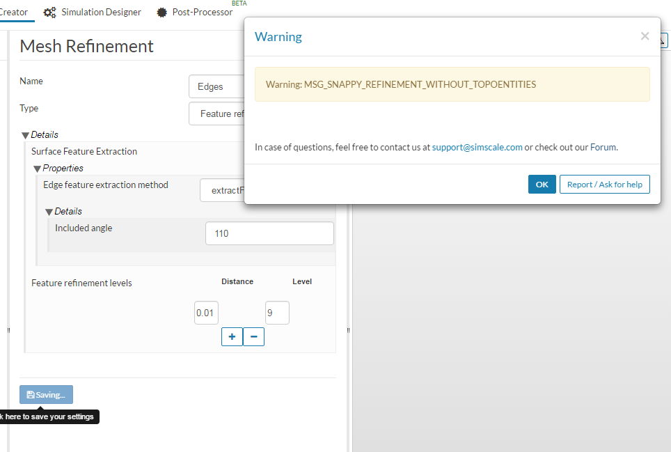

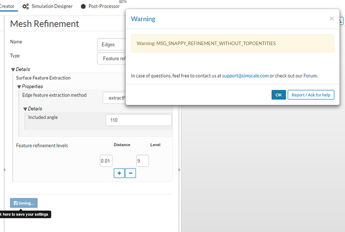

I had to increase the size of the domain, and ended up with a very large mesh, so to try and create a more sophisticated mesh, I used this Tutorial as a method:
I am having some errors, and the mesh is taking very long to generate. Could you have a brief look at my method, and see if you can make some recommendations?
Hey @Tugwell!
This is not an error. This is just a warning since this refinement is done without assigning it to any topological entity. This warning will not effect your result.

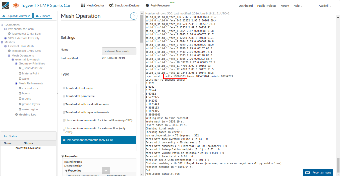

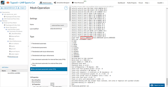

Hi, @Tugwell Your geometry is nice. The problem is you are giving very high degree of mesh refinements during meshing. That is why your mesh size is huge. Even if you get a mesh, your simulation run will take ages to complete. Look at the mesh size
Mesh refinements are trade of between mesh quality and mesh size. Try to keep your mesh size as small as possible with acceptable results. Do not use unnecessary mesh refinements. For the reference we made a mesh using your geometry. You can work on this mesh and change it according to your requirements. Here is the link for this project.
If you need any further help, feel free to contact. Have fun
