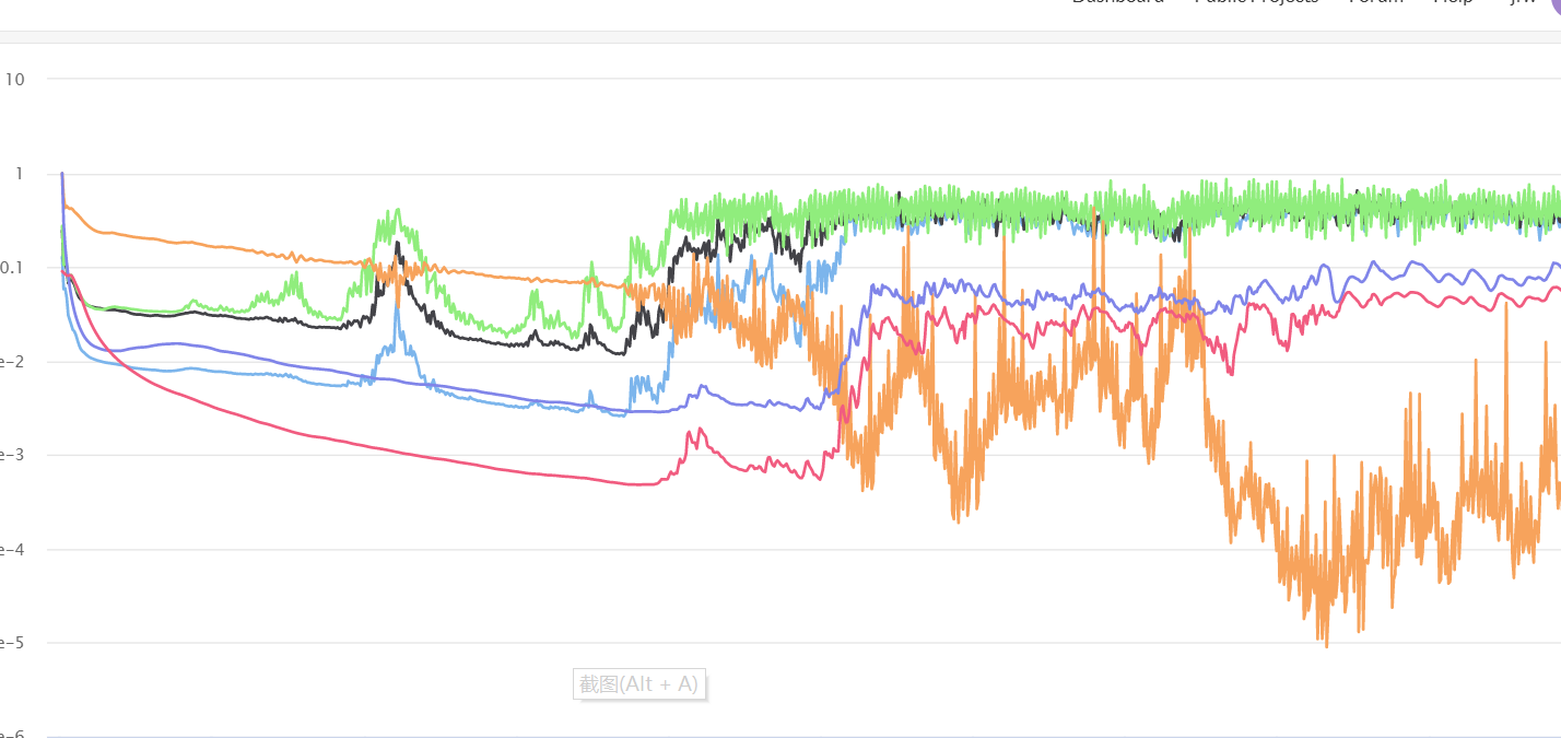

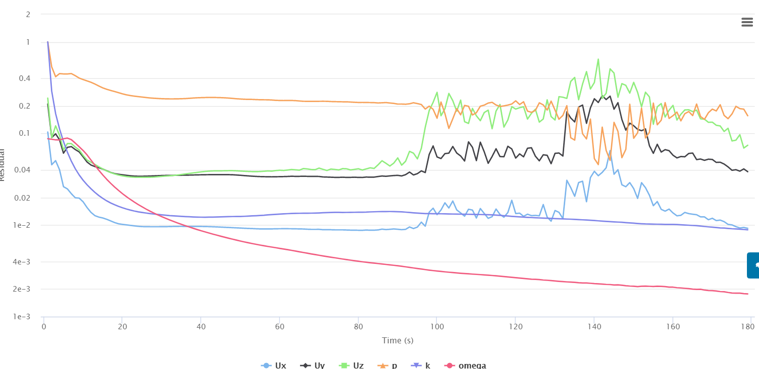

hello every one i want to know what the problem of this simulation?
because the convergence plot seems not very good.
how can i fix it and make the right simulation result?

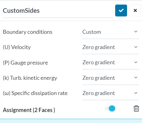

Hi @jfw: I suggest you set your ‘sides’ and ‘sky’ to ‘transparent’ BC. It is the case when you use Custom BC. Example is below:
Currently your slip BC are kind of reflecting the pressure and causing the huge value of ‘Continuity error’ in your log file. You can make simulation domain much bigger in order to avoid that problem, but I suggest to use that zero gradient BC and observe convergence.
