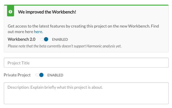

Hi @mhatwar and sorry for the late response.
You could download the geometry and switch the button on the top (see picture below).
However we would recommend using the new workbench as the old one will successively vanish. We are also working on changing the tutorials for the new workbench accordingly so thanks a ton for your feedback
Let me know if you have any further questions. Happy SimScaling!

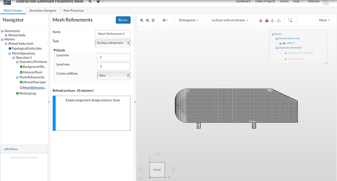

I wanted to switch to old workbench because I have some issues with the one I am currently using. I am trying to use surface feature refinement but cannot select the face or solid. I think it is something very simple but I could not figure where I was going wrong. Can you please help me with it?
I am attaching the screenshot here.
Thank you
Hi @mhatwar!
Have you tried right-clicking on Operation 1 and Delete Results? That should do the job
