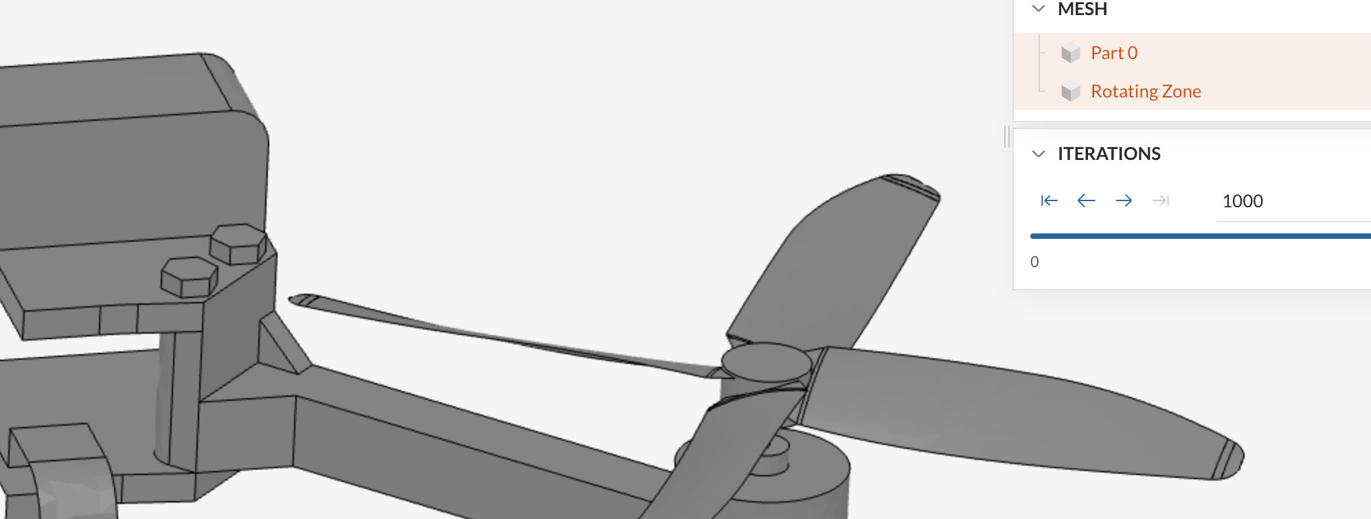

I’m loving SimScale so far. Smooth interface and easy to use. I’m trying to go through the tutorials to get up to speed. I got the Drone to simulate, but made it to section 5.1 of the tutorial before running into a problem. I change the Parts Color to Pressure and the drone turns gray. And my meshes are red? Any help would be appreciated. Thanks!

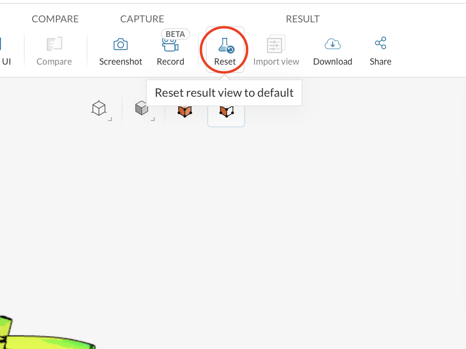

Please try to reset the post processing by this button below and then apply the Pressure Filter again.
And please let me know if this helps you.
That did it. Thank you!
