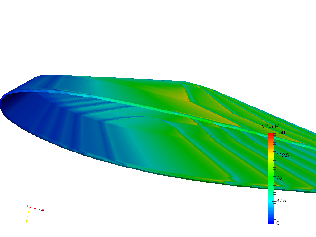

Have some problems with my project, i want to make a boundary layer but have some issues with my geometry. Cant split and scale at the same time… is there a way to do this without make new stl files.

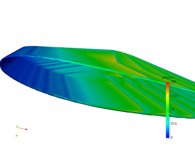

But how to analyse the y plus value? is this the right way to do it?
You can use the scaling option and the split option both in the Mesh Creator tab. The way you analyze the y+ value is correct to see if you are using a valid turbulent setup.
