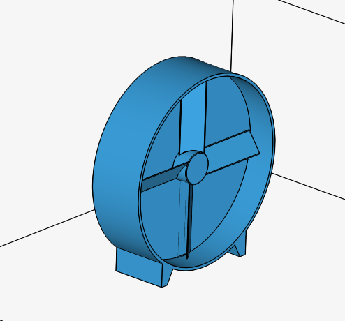

I am working on a project about the flow of a fan.
The link of the project is the following: SimScale
I have run various successful meshes and simulations in different geometries.
However for some reason, I can’t mesh the geometry of the simulation called “No MRF”.
This is the message that appears after each attempt.
It is strange because it is a geometry that I have meshed in the past and the process was not even expensive in core hours.
Can anyone help?
Thanks!
Miltos

Doesn’t seem like a small mesh.
I tried to run it and cut it after 3 hours.
Thanks a lot for your effort.
The mesh has been generated for this geometry. It costed 2.3 core hours.

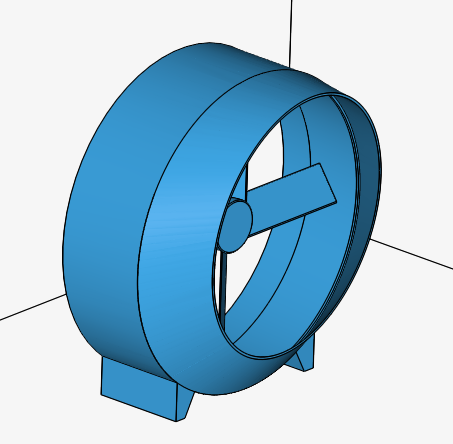

Then I copied the mesh and tried to generate it for this geometry.
The only differences between them is that the second geometry has a surface behind the blades and the nozzle is gone.
So I assumed that the meshing cost would be similar.
In any case thanks again for your efforts!

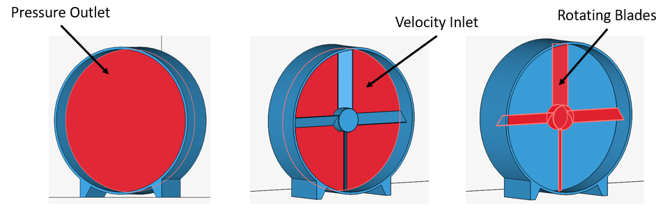

Hi @miltos980,
Just to double check, what is the purpose of having a physical wall right behind the blades? This is going to fully block the flow.
On a side note, the memory issues are likely caused by small gaps between the additional wall and the rest of the structure.
Hi RicardoParis,
Initially I used the MRF method to simulate the flow that is generated from the fan.
Then I wanted to see if different results come, when I have the following approach.
